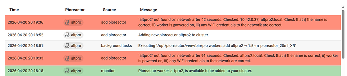

how do we overcome this error, the leader’s SSH is on
Hi @altproUW, sorry about the delay. Hm, it’s interesting that it was “discovered”, but couldn’t be added to the cluster. The name is case sensitive, so make sure your not mixing uppercase letters in one set up and lowercase letters elsewhere.
Can you SSH into the leader, and try:
ping altpro2.local
What does that return?
