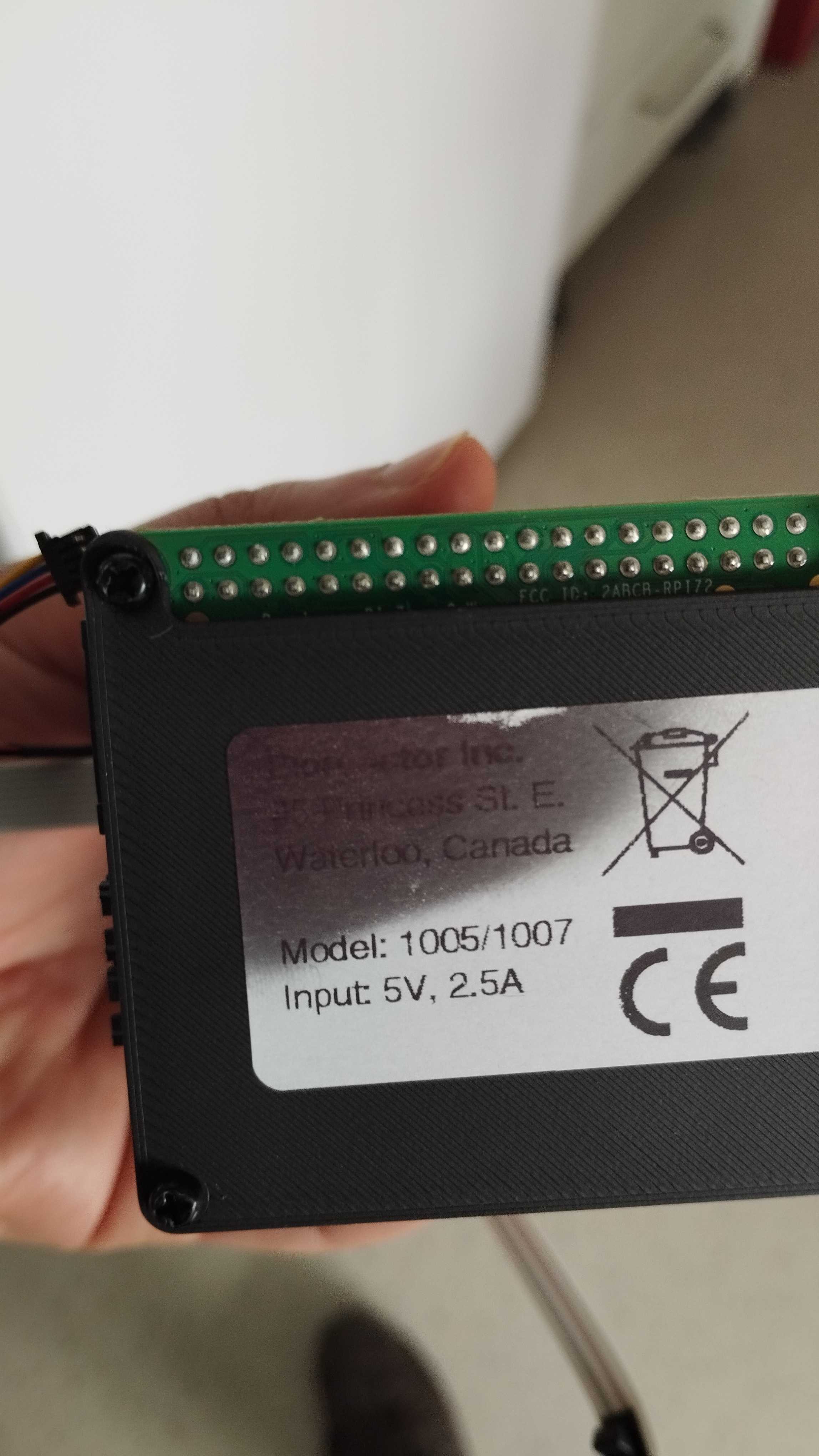

I reconnected the power input and so on, it didn’t have any light flashing. I think the PI was dead, maybe over heated because I saw the bottom of the pioreactor.

This seems fine, and the “heat” mark on the sticker is normal (we use thermal paper for those stickers, so this is normal behaviour - it’s on our list to update).
