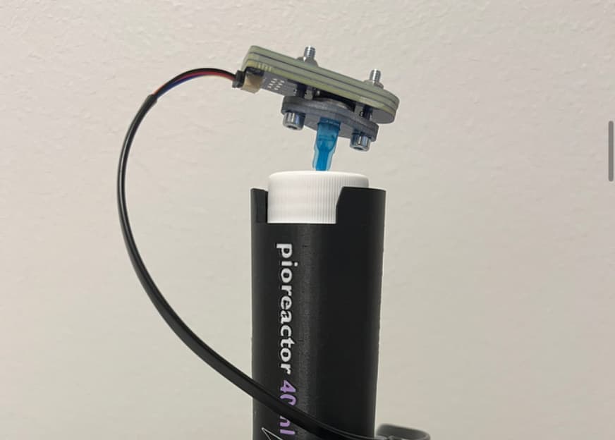

I’m posting to see if anyone could help me think through a possible redesign of the Vial Cap S. I work with anaerobic cultures in batch fermentation, and one of the recurring problems I have is oxygen getting into the vials.

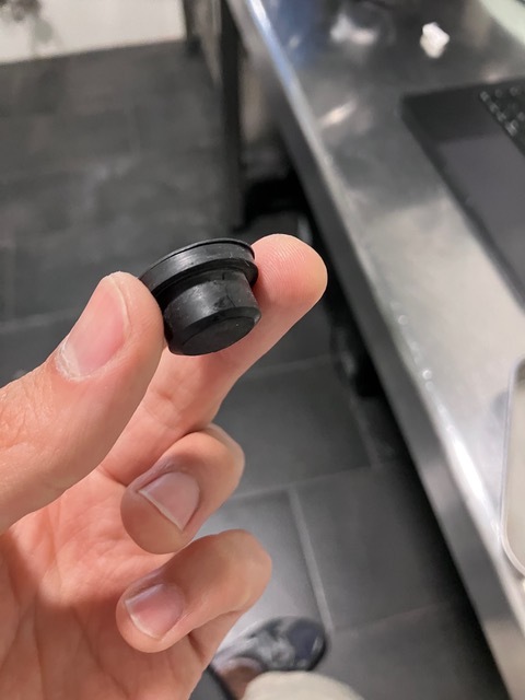

I’ve been considering using the type of setup discussed by the colleagues at Learke. One possible approach would be to add a larger septum to the Vial Cap S, so that it could accommodate the silicone plugs they use (see attached picture). I think this could be particularly useful for working under pressure, as I’ve had my vials reach around 3 bar.
However, in practice I usually work with Luer-type airlocks/check valves, which are available at different pressure ratings and are quite inexpensive.
Because of this, I was wondering whether a simpler redesign might be enough: seal the existing holes for theports, keep the self-healing plug for the pressure sensor and other needles such as the Luer-lock pressure valve, inoculation, sampling, etc.
I’d be very interested to hear how others would approach the redesign (my skills in CAD are rather limited).
Thanks!!!

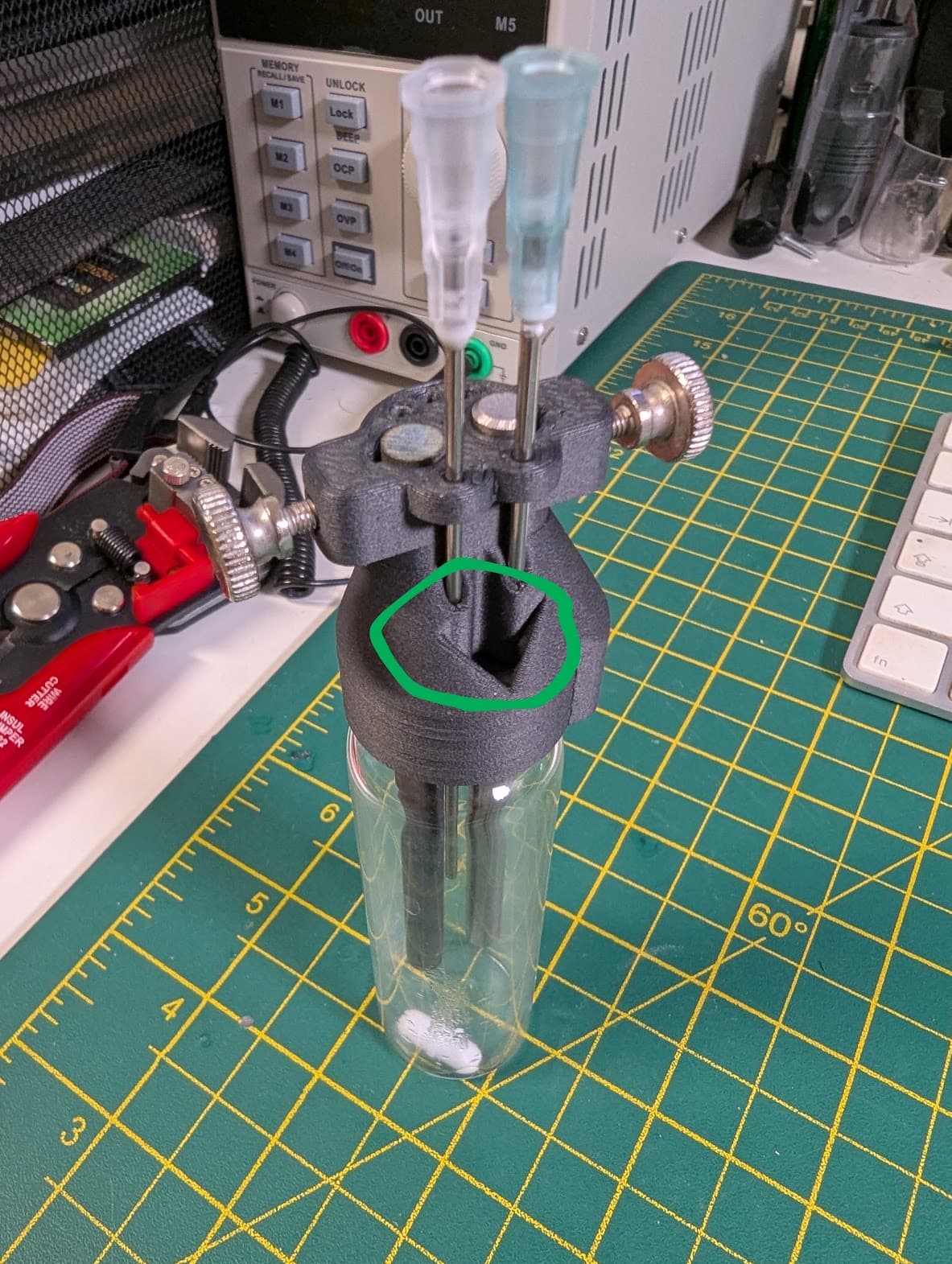

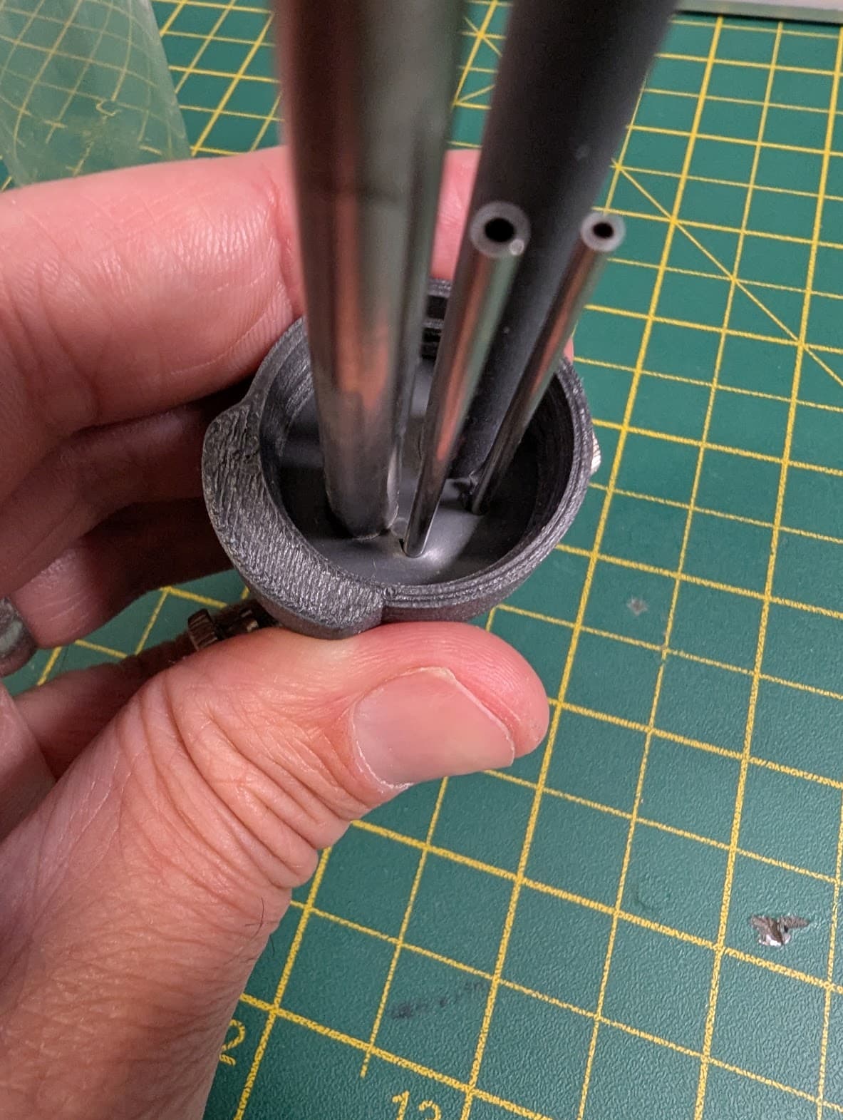

@Martin and I have been working on a vial cap design for the electroPioreactor that has a silicone seal across the entire inside of the cap:
We leave an opening in the top of the lid (see part circled in green) to act as a self-healing inoculation port:
The silicone seal is 2mm thick, so doesn’t deform too much when you push the stainless steel ports through. So far it does appear to be airtight at low pressures, but needs more testing.
