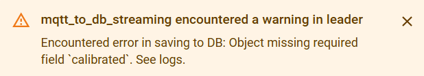

Hi guys, I have updated the leader to 25.4.11 to solve the “PCB not responding” issue, but now i am getting a new warning:
Do you think the issue is that my leader is at 25.4.11 and the UI is at 25.4.9 (this is the most recent right)?

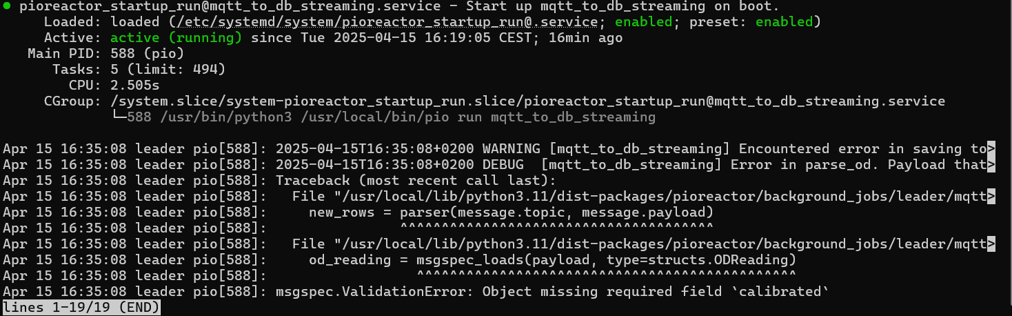

I tried to check if the mqtt_to_db_streaming.service is running:
Do you have any idea what is happening? I am not too worried because mqtt_to_db_streaming.service seems to be running, but it is bugging me that the warning keeps popping up every 1 minute.

On that sudo systemctl status pioreactor_startup_run@mqtt_to_db_streaming.service output, you can press the right-arrow key to view more to the right (it’s cutoff). If you do, you will probably see the message that is causing the problem, which would include a pioreactor unit name - does that provide any clues?
The missing part of the message is this: Error in parse_od. Payload that caused error: {"timestamp":"2025-04-15T19:06:13.841774Z","angle":"90","od":0.0021015880433365676,"channel":"2"}

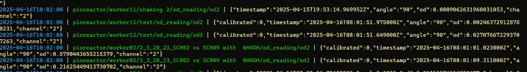

Ok this helps a lot! I see that worker9, 10 and 11 don’t have the calibration field. These are not assign to the experiment that is running now, so thats ok, i will power cycle them tomorrow because rebooting them remotely didn’t fix it. But good to know that the workers that are actually running an experiment now are logging the ODs. :slightly_smiling_face:
Today i power cycled them and tried again here is what i get:
I notice that for worker10 and 11 first it doesnt say “calibrated”:0 and then on the next line it does. while for worker02 and worker03 it says “calibrated”:0 immediately.

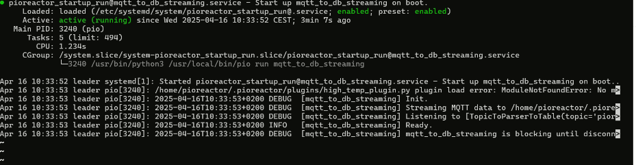

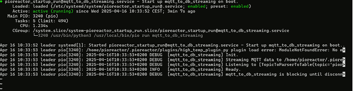

But this looks right:
And the warnings have stopped. So maybe its solved?
