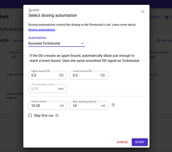

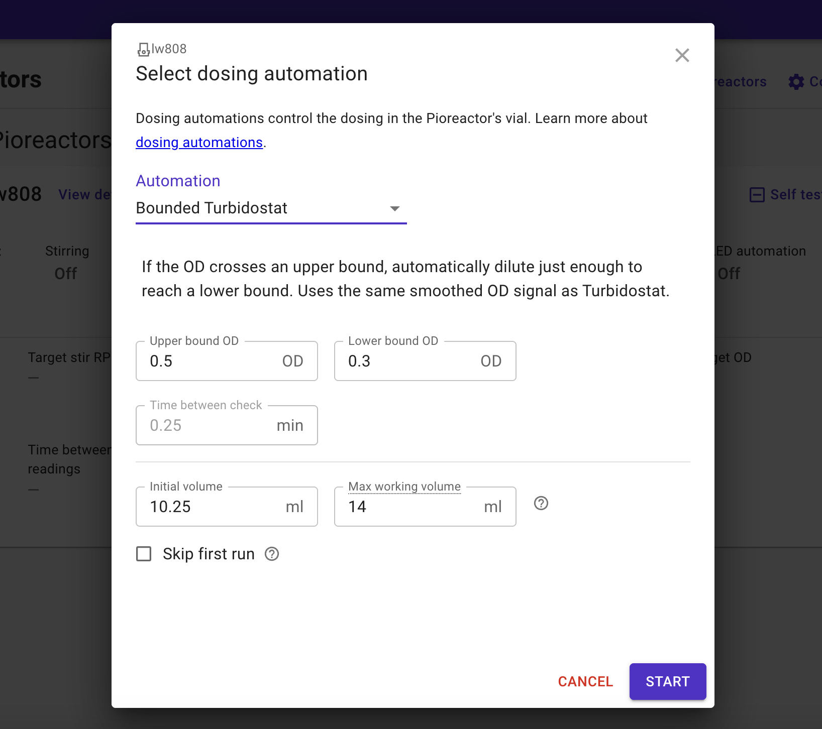

It’s not a native automation, but I’ll give you instructions on how to add it:
  1. SSH into your Pioreactor leader (or only Pioreactor)
  2. enter
    nano ~/.pioreactor/plugins/bounded_turbidostat.py
  3. This opens up a text editor. Copy and paste the linked Python code.
  4. Save and exit with ctrl-x
  5. Optional: Next, distribute this to any other Pioreactors in your cluster:
    pios cp ~/.pioreactor/plugins/bounded_turbidostat.py

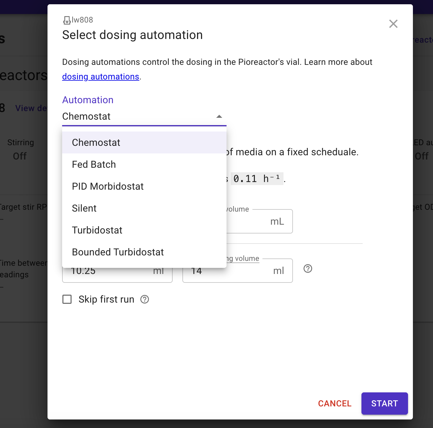

  6. Add the automation to your UI:
    nano .pioreactor/plugins/ui/contrib/automations/dosing/bounded_turbidostat.yaml
    and copy and paste the linked code.
  7. Save and exit with ctrl-x.
  8. Refresh your UI, and you should see the following:
Let me know if you encounter any problems or are missing some feature!
