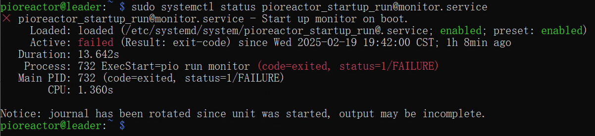

Hi @xykb86, rest assured your data is safe
It sounds like some start-up processes failed to start. Can you SSH into your leader Pioreactor and report back the output of
sudo systemctl status pioreactor_startup_run@monitor.service
“Pio run monitor” returns the follow:

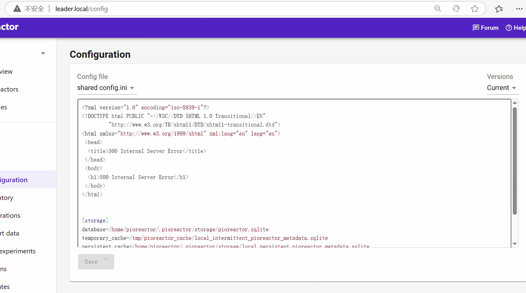

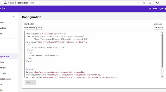

Now, it seems that I cannot access the full config.ini. I can only see shared config.ini:
Is it possible to add the [storage] info to config.ini through ssd/cmd or write to microSD directly?

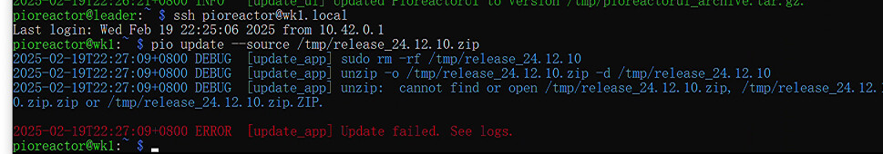

For the workers, I tried
  1. starting from step 2, changing @leader.local to @wk1.local. It returns:“ssh: Could not resolve hostname wk1.local: \262\273\326\252\265\300\325\342\321\371\265\304\326\367\273\372\241\243
    lost connection”

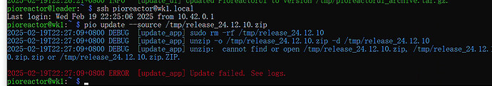

  2. ssh to leader, then to wk1, put in the commands from step 3. It returns what the picture shows.
It seems that the workers as nested inside the leader have hard time finding the “tmp” folder.
BTW, the workers are hooked to the leader through local access point.

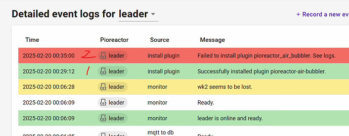

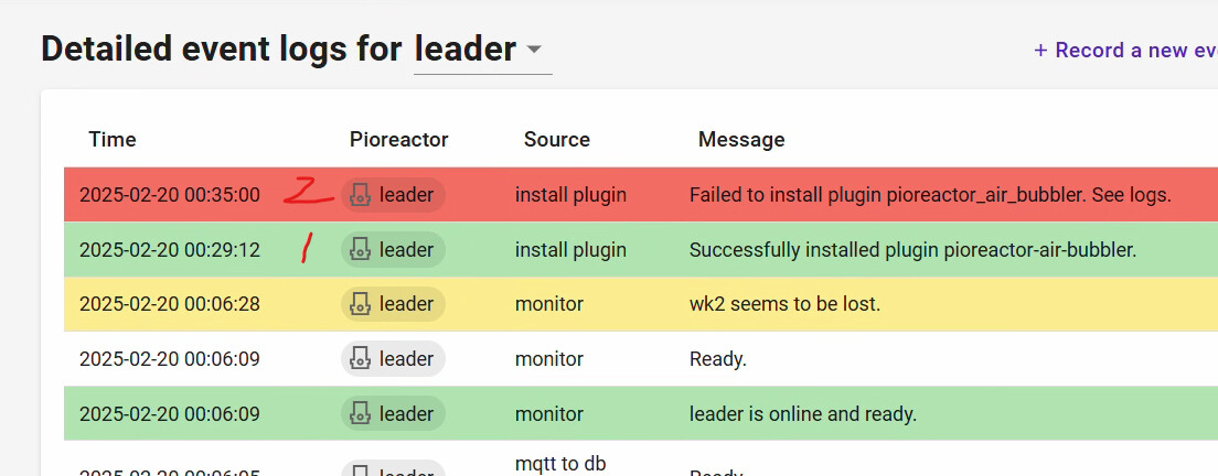

Sorry to bother you again. But I cannot install air bubbler any more.
I tried both the command of “pio plugins install pioreactor_air_bubbler” and install across the cluster at the UI. Neither worked.
Any suggestion? Should I download the file locally and install from there?

pioreactor@leader:~ $ pio plugins install pioreactor_air_bubbler
2025-02-20T00:34:24+0800 DEBUG [install_plugin] Installing plugin pioreactor_air_bubbler.
2025-02-20T00:34:24+0800 DEBUG [install_plugin] bash /usr/local/bin/install_pioreactor_plugin.sh pioreactor_air_bubbler
2025-02-20T00:35:00+0800 ERROR [install_plugin] Failed to install plugin pioreactor_air_bubbler. See logs.

event 1 resulted from install across the cluster but I did not see the setting options from the Pioreactor panel.
event 2 resulted from running the command line instruction.
So you don’t have internet access (that’s okay!) - did you try my scp instructions?
I believe it is a firewall issue (I am from China). I solved it by using VPN. Thanks a lot for your help!
