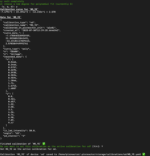

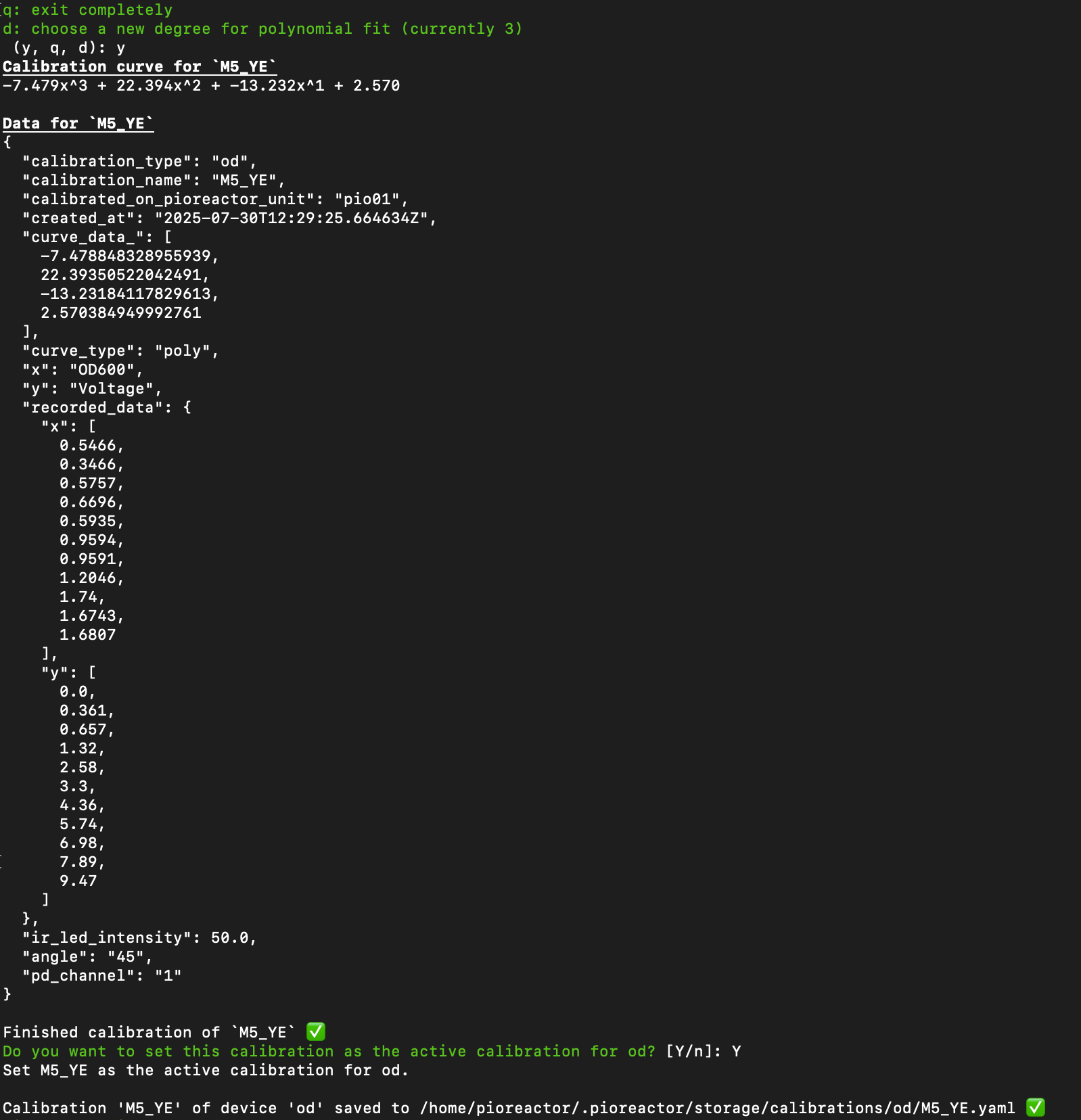

I am using running the calibration using:
pio calibrations run --device od --protocol-name od_calibration_using_standards_from_file --data-file calibration_od_45_pio01.json

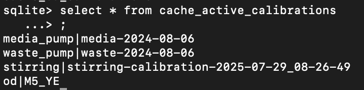

See background job attached which you kindly helped us with before. It appears to have been successfully run and set to active as indicated by:
- the CLI tool

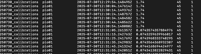

- I can also see it in the cache_active_calibrations in the local_persistent_pioreactor_metadata.sqlite on the worker

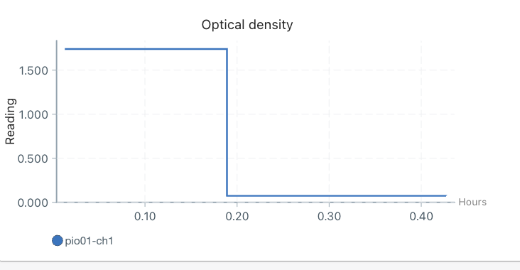

- the changed OD values in the database on the leader (and also in the graph) (I updated the calibration at 12:30)

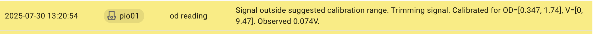

NB the OD and voltage are the wrong way around but otherwise we get this error:

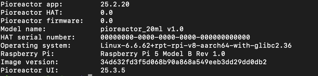

We are on the following version:

Yes, that was fixed in 25.4.3.

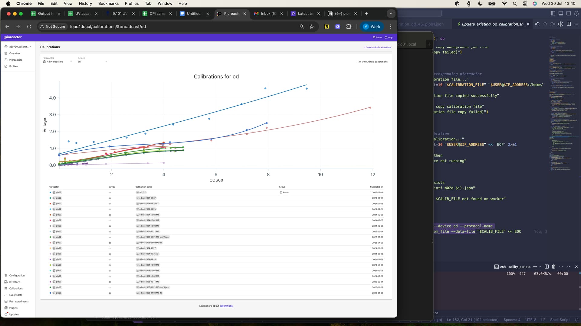

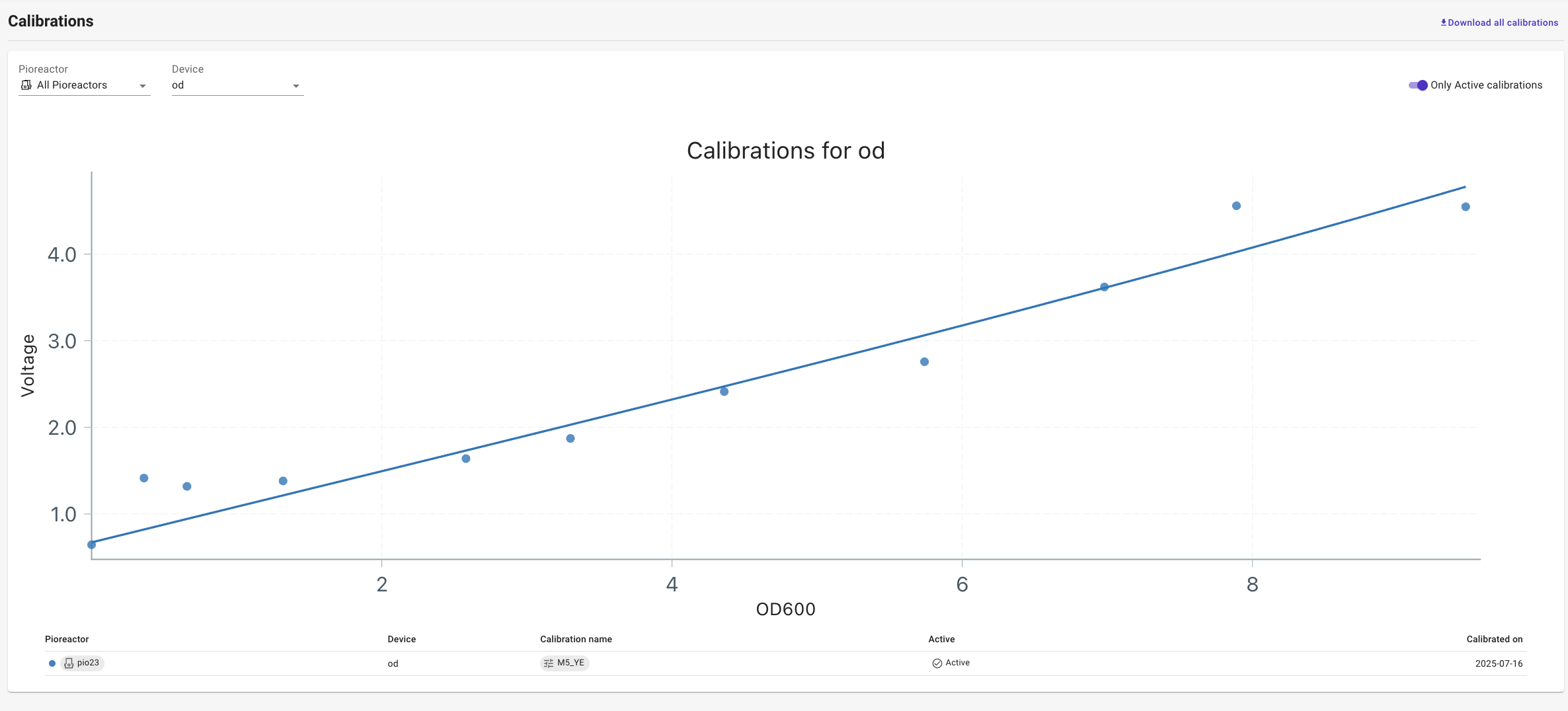

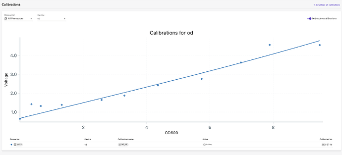

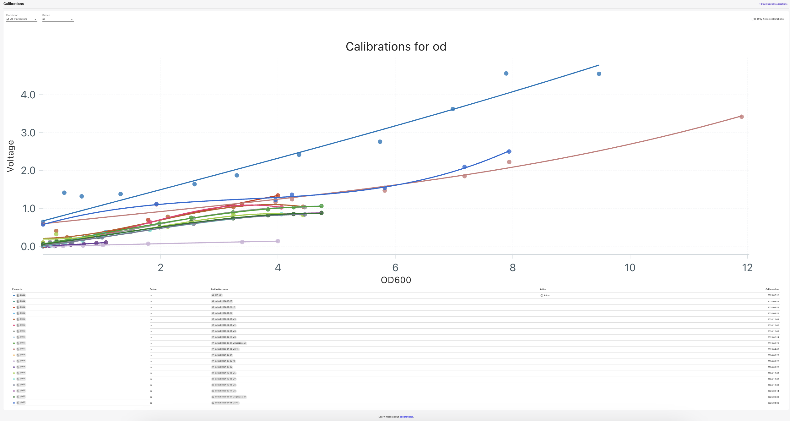

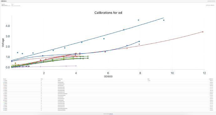

Hi Cameron, thanks for getting back to me. Here is some clearer screenshots. The worker I was testing it with was pio01. On the calibrations tab - “M5_YE” (the name of the od calibration) is not showing up as a calibration at all and not as active either. We have a lot more od calibrations, which aren’t been shown at all or active (just using pio01 and this calibration as an example).

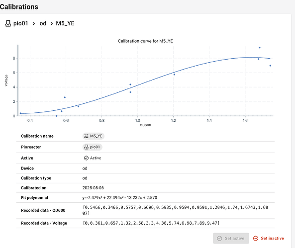

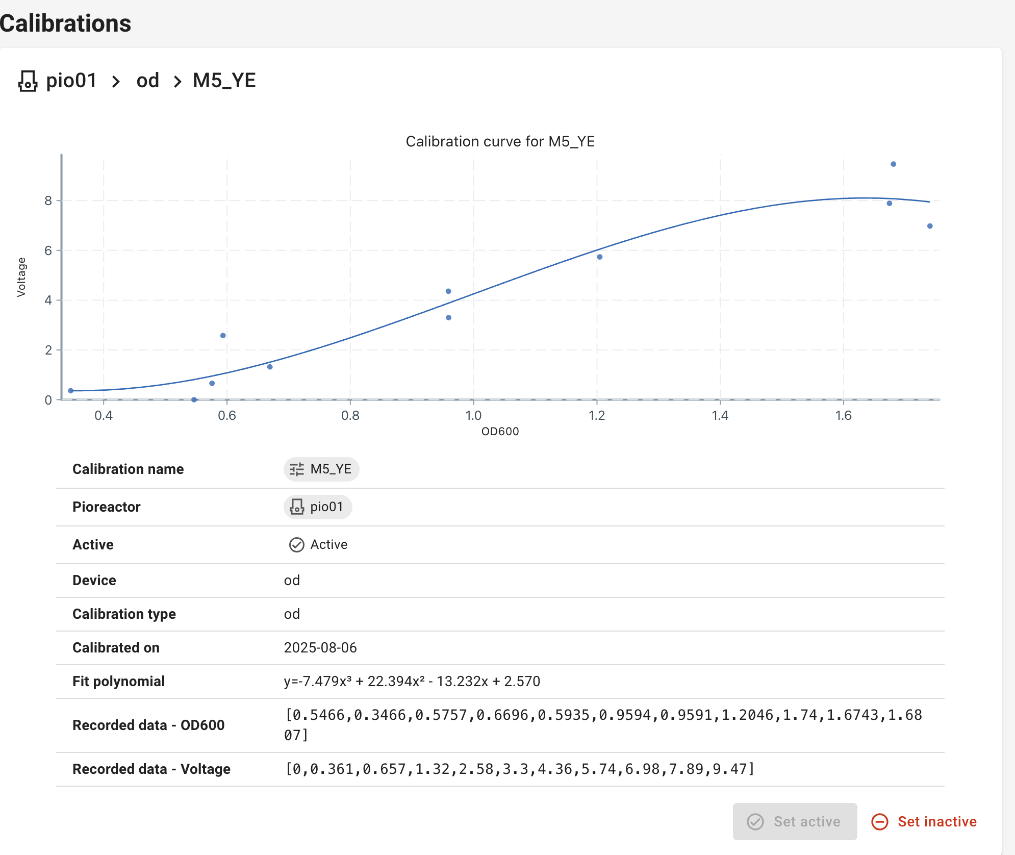

Hm, I’m not totally sure what’s going on then. In your browser, does the URL:
<your pioreactors ui url>/calibrations/pio01/od/M5_YE
work?
Possibly an upgrade fixes this, as there was some earlier bug that has been fixed, but no promises.
Yes, that works! I’ll let the scientists know they can check like that if they want to know whether a particular calibration is active or not. Will let you know if still an issue once we upgrade but great to have a workaround for now. Thanks!
Okay cool. I think it’s timeout issue (like, the leader will ask the workers for calibrations, and if they don’t response within TIMEOUT seconds, it just defaults to a empty list. The default timeout was set too low (1 second), which I think is the problem here).
