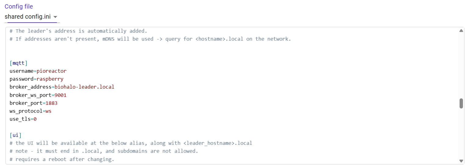

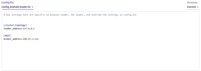

  2. Yes, I did change the IPv4 address to match the one provided by Tailscale. Here is the leader config file:
And the shared config:
Changing the broker address in each config file individually does not fix the issue.
Hm, I believe it should be the opposite:
  1. the shared config file should have the ipv4. This is the config that the browser uses to connect to the leader’s MQTT. So your browser/personal machine needs to fetch from the ipv4 address (there isn’t a biohalo-leader.local on your personal machine’s network when your machine is remote, but there is a ipv4).
  2. The workers (if any) should have the .local. address.
  3. Your leader’s config should also have the .local address, or localhost is fine, too.
