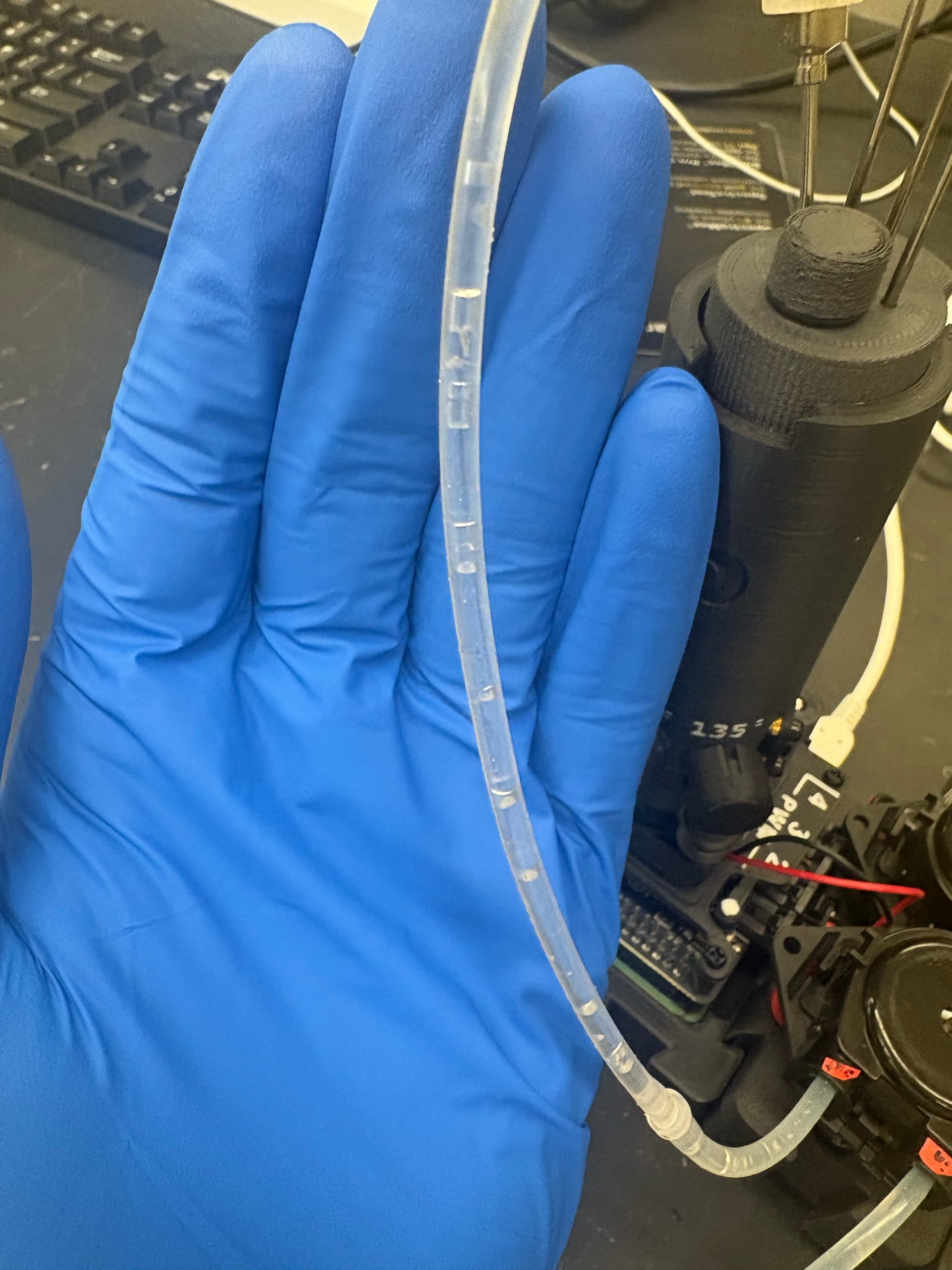

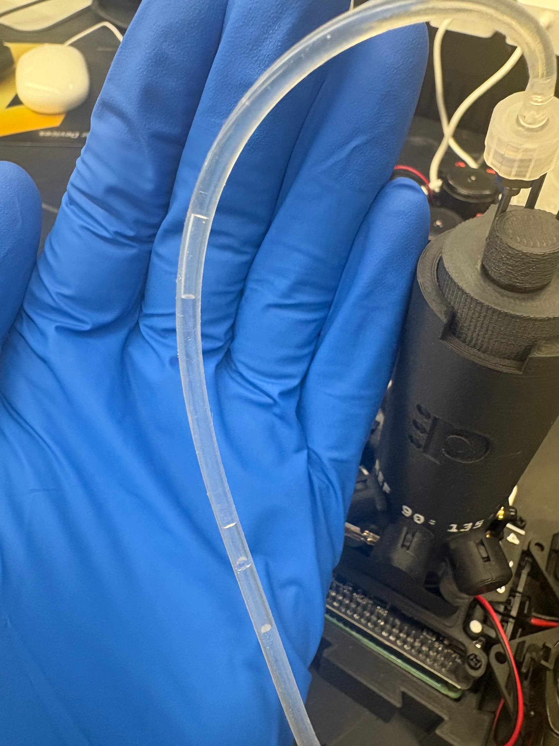

I’ve been running some experiments (chemostat or fed-batch dosing scheme) at very low flow rates (i.e. dosing 0.05 mL once every 2 hours). I’ve been having issues where even with very careful priming of the pumps in place so there’s no disturbance, I still get significant air bubbles in the tubing between the pump and the Pioreactor vessel. Since I’m dosing so infrequently and with such small amounts, missing a dosing event due to air bubbles (since each dose is essentially one droplet from the needle into the vessel) is clearly quite impactful to growth dynamics.

Hi @DonalC, these look like the older silicone tubes we use to ship with the pumps? Can you confirm that? Our newer tubes have black print on them. If so, these tubes did have this exact issue - too permeable to air. We now supply different tubes, FLEXELENE 135C, that are much more impermeable to air.
Do you want us to send you some replacements? Alternatively, look for 1/16" ID 1/8" OD platinum cured silicone tubes.
