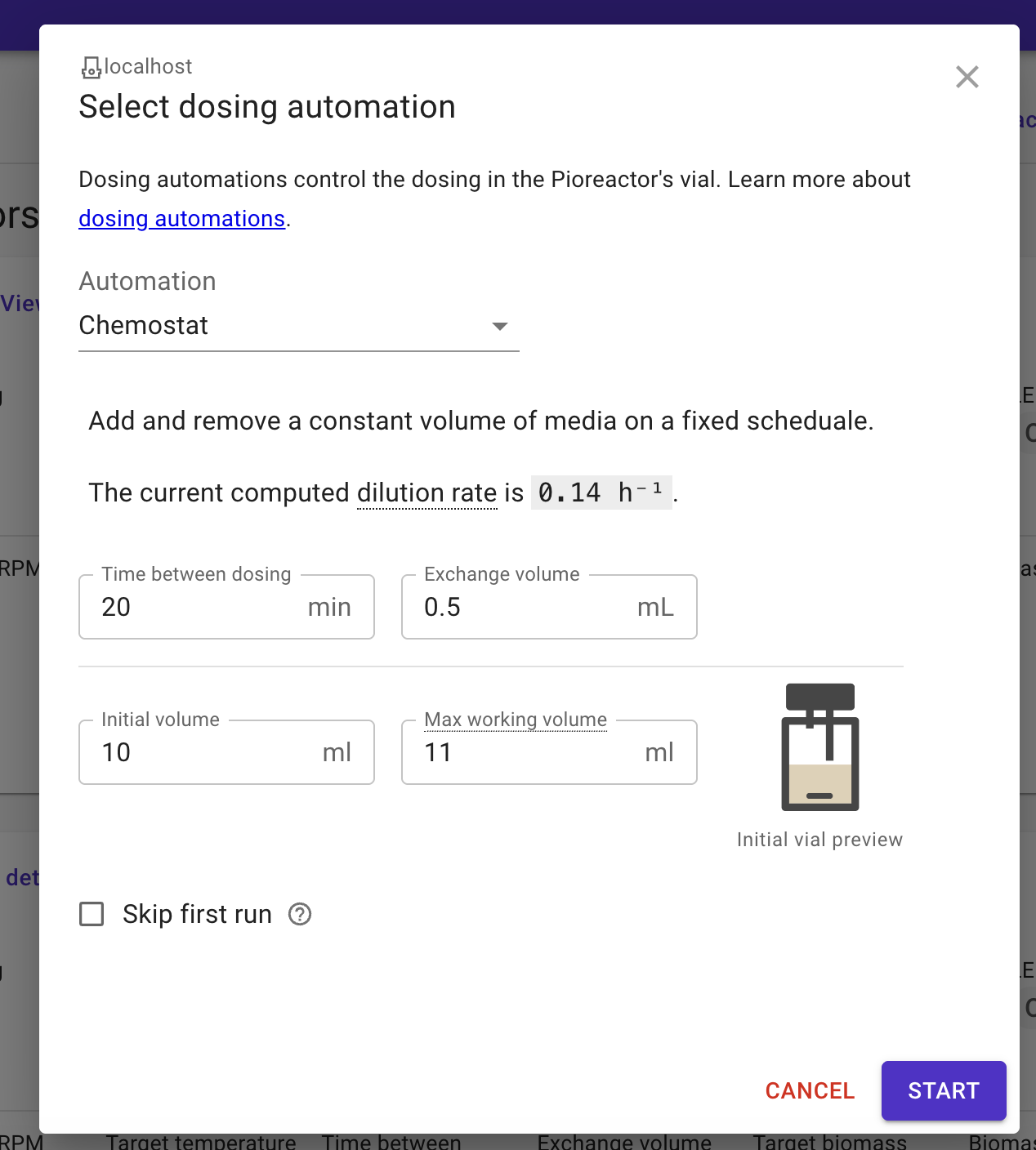

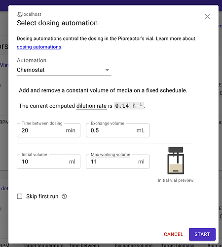

I’ve added a diagram to make these fields more clear :crossed_fingers::crossed_fingers:
