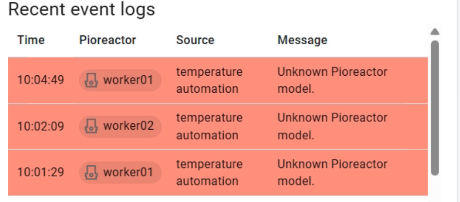

I changed the Model of my pioreactors to custom_100ml v1.0, but now the temperature automation is giving this error:
temperature_automation encountered an error in worker02
Unknown Pioreactor model custom_100ml v1.0.
the UI is in version 25.8.14 same as the workers.
How can i fix this?

Hi @Cameron, thank you for looking into this. Yes the .yaml file was distributed to all the online workers. And i get the Model: “custom_100ml, v1.0” option in the inventory.
But i re-distributed it now and now the automation starts and then after a few seconds it throughs this error:
ooooh yes, I see. It’s a bug, kinda. The software doesn’t know how to handle temperature inference on non-Pioreactor models. However, you can continue to use our inference if you change the model_name field to pioreactor_20ml or pioreactor_40ml in the YAML (then redistribute it).
I’ll change this to be a warning instead of a total error.
Perfect, the renaming trick fixed my issue. Now the thermostat is working fine. :ok_hand:
