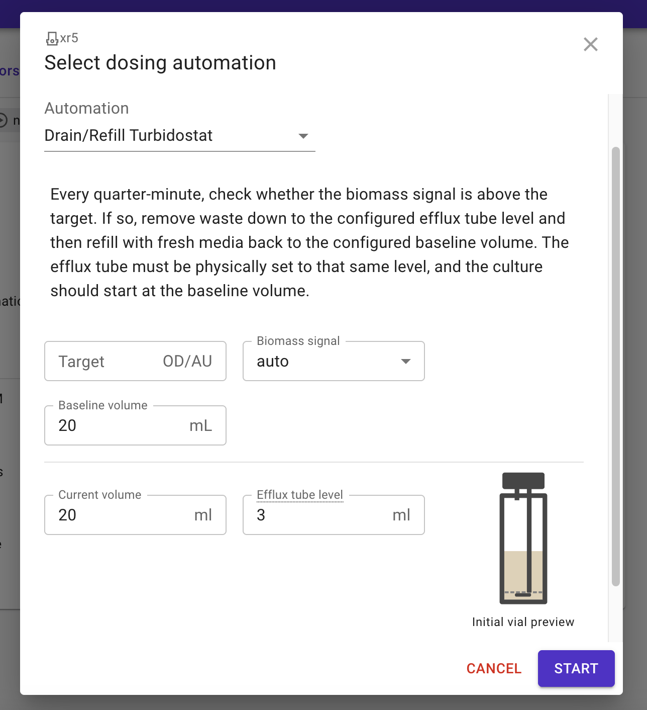

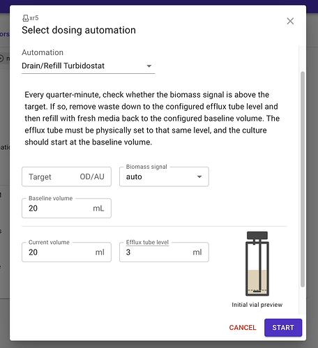

I made this automation with version 26.4.0 in mind, since that does some re-naming which makes the visual more clear.
Use the two files here: drain_refill_turbidostat.py -> ~/.pioreactor/plugins, drain_refill_turbidostat.yaml -> ~/.pioreactor/plugins/ui/automations/dosing/ · GitHub

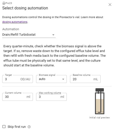

Can you tell me what you see here? (Specifically: what you expect to see, and instead what occurs)
This is what I see. There is no efflux tube field and it triggers an error saying “DrainRefillTurbidostat.init () missing 1 required positional argument: ‘efflux_tube_volume_ml’”
This could be a cache issue. Try a hard-refresh in the browser.
