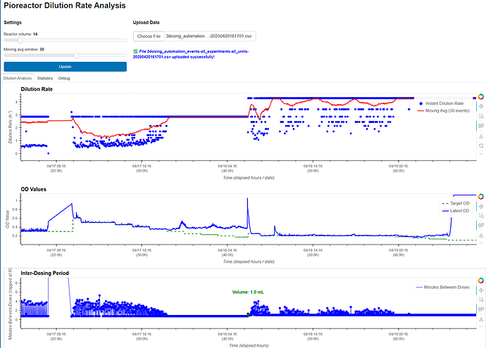

I have been trying to figure out the max specific growth rate of a microbe by stepping the dilution rate, or more recently the target OD in turbidostat mode.
I have dilution rates well above what a max specific growth rate should be and at time i haven’t been able to get the OD down with increased dilution rates.
- It’s possible my OD is off, as my blanking was wrong and that .3 is actually blank and washout. regardless…
- The dilution rates are WAY too high at nearly all points. My only guess is that the reactors can’t properly mix and dilute, so the fresh media that is added on top is mostly what is getting removed, keeping the bottom of the reactor from getting diluted and causing way more media cycling than should be necessary. In that case the dilution rate will not equal the growth rate.

There is also a limit based on your dose volume and pump speed too. I had run into the maxium effective dilution rate because the dose was only .5ml and at top speed it was cycling every 45 seconds. I set my profile script then step up the dose to 1ml. Still I’m not sure how long it will take to mix well. Also not sure what the most effective dose size would be.
