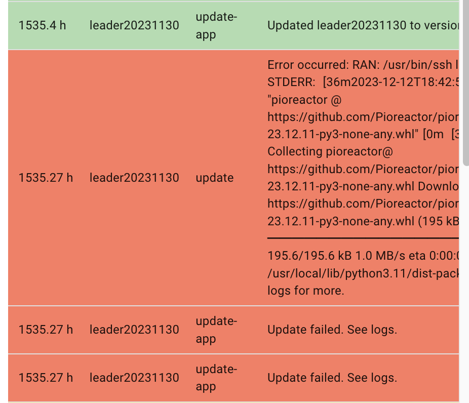

I did see an error when I “updated to next release” from the UI related to some update scripts. I just fixed this, and you should be able to rerun “updated to next release” to fix it. Here’s the error I observed.

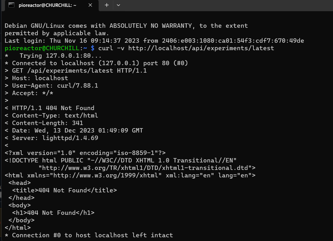

Another thing to test is if the web server still is working. Try sshing into your leader, and trying:
curl -v http://localhost/api/experiments/latest
Do you see something like the following? gist:3ff683a811044c720a3157f72c40c843 · GitHub
An affirmative here suggests the server is fine and operational. But also look at the UI logs for anything suspicious:

I ran the web server test and got this output:
The UI logs gave me this, although I’m afraid I’m not certain what it’s telling me!
huh, maybe your webserver’s not working, or it didn’t come back up successfully after the update. Have you tried power-cycling the leader?
