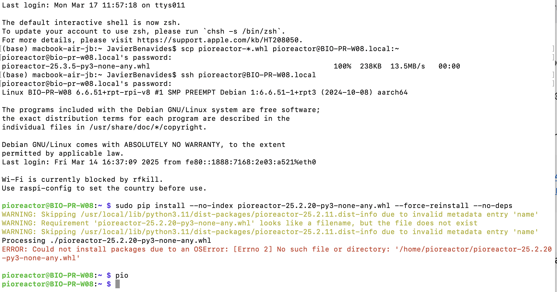

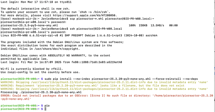

Thanks for your answer!
I tried to do so but obtained this error:
I managed to install the software :slight_smile: I can access the pio command now in the terminal. I realized that the 25.3.5 was downloaded instead of the 25.2.20.

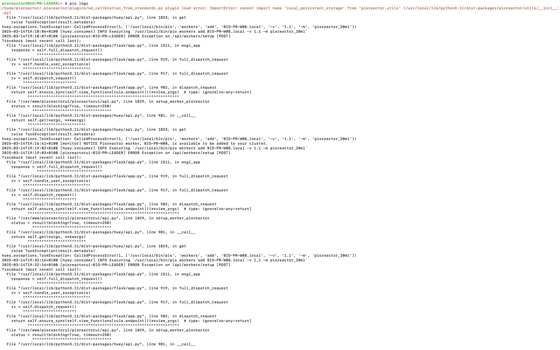

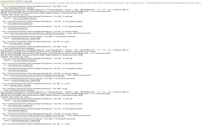

Okay, hm, that sounds like an error on the leader. Can you SSH into your leader, try pio logs and see if there a recent error there?
Are other parts of your UI working, or is it just this that is showing an error?
Everything else in the UI is working fine. The leader is online and responding. This is what pio logs gave as output. The first error is about a plugin that stopped working after updating to 25.2.11.

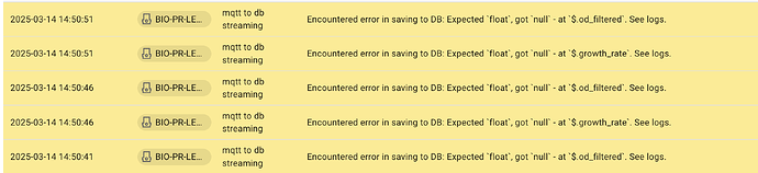

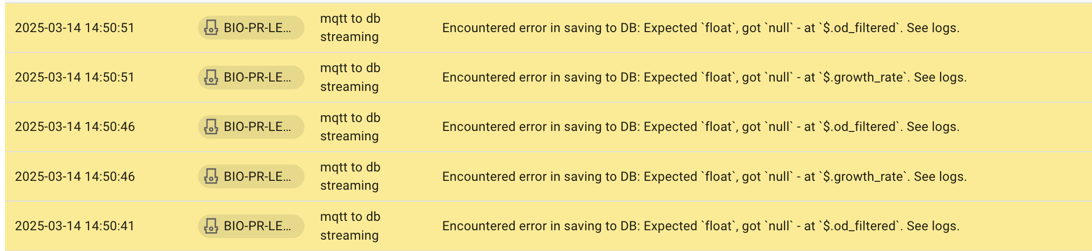

Also, in the UI I found these errors a couple of days ago, but I don’t think this has to do with the workers connection
Got it.
  1. That plugin is deprecated, and 25.2.11 introduced the calibration standards option natively in Pioreactor. You can delete it from the workers with (from leader):
    pios rm /home/pioreactor/.pioreactor/plugins/od_calibration_from_standards.py
  2. Looks like I’m not catching an error well in the backend. Anyways, try this on your leader:
    pio workers add BIO-PR-W08 -v 1.1 -m pioreactor_20ml
Let me know what that returns.
