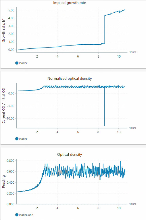

Ever since update to the latest version (25.2.20), growth rate calculation becomes erroneous. As shown in the figure, it seems that the filter made a mistake in generating current/initial OD which resulted a jump in grwoth rate.
Any suggestion in how to tune the parameters?

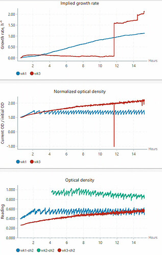

——This problem is across the board with multiple devices. The following is another example.
Yuck! Something is very wrong if you’re seeing negative Normalized ODs.

I’ll try to replicate it locally today. My best guess after looking at the data is some numerical instability in the Kalman Filter inference.

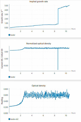

So I “replayed” the GR and nOD inference using your od readings - and I successfully replicated the bug!
We have an update and improvement to the algorithm for the next release, but here’s what you can do now. Change the ekf_outlier_std_threshold config parameter from 3.0 to something like 10.0.
