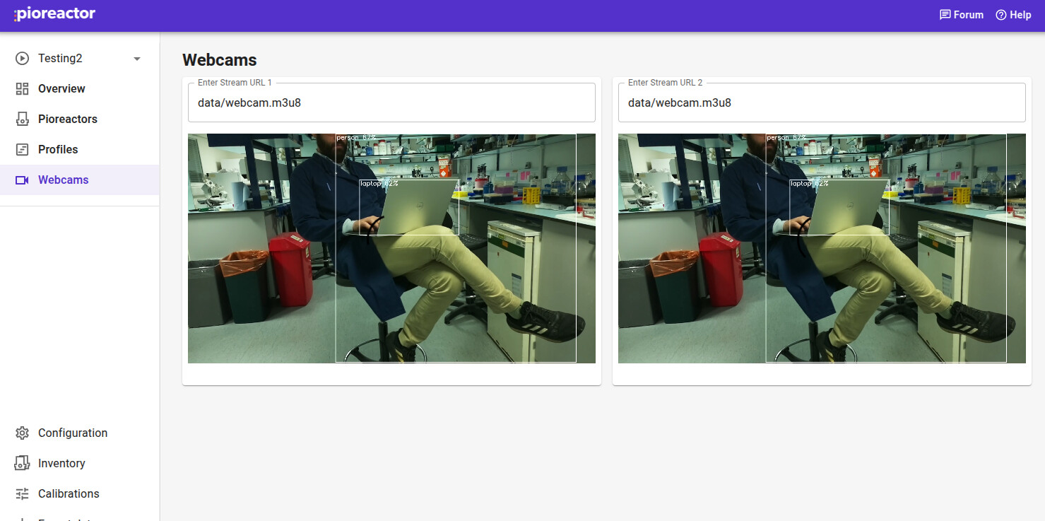

Hi Noah!
This is really cool, I am planning on adding some cams into our incubator. Is there anyway this could be implemented as a pluggin for those (like me😅) that have no coding experience?
Bests and thanks!
Hey! Happy to have a more in depth conversation, and will try to set something as a plugin at some point, but two quick lessons for now:
  • We’ve found in our case snapshots every 5 minutes to be more useful than video. We mainly just want to check for foam and have a log of what was happening over the course of the experiment and that does the job. It takes up much less room than continuous video. Streaming was sort of helpful but actually we’re more often interested in whether we missed something or what’s changed than exactly what’s going on right now.
  • Webcams tend to be better than the rpi camera because I think things might have changed since the last time I posted here getting it working. The rpi cameras have really short leads. Webcams take up a lot of CPU if you’re recording continuously but if you’re ok with snapshots as discussed above they’re just more convenient and cheaper
We have a job that is triggered by cron every 5 minutes and then rsyncs to a Google cloud storage bucket
Hi there Noah! Thanks for this :slight_smile:
Ok, it makes total sense. In my case I want to track the Pio when I am not in the lab, I work with pressure fermentation and being able to check that there haven’t been any unfortunate explosions (it has happened before😅) let us turnoff the system from anywhere to avoid damage. So I think that for this maybe having a webcam makes more sense, in witch I can set some alarms if an object moves drastically (like a vial lid).
Thanks a lot!!! I’ll keep you posted if we make more advances.
