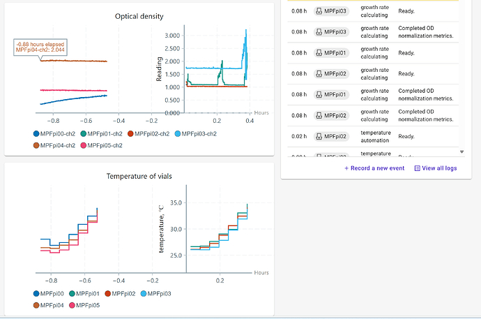

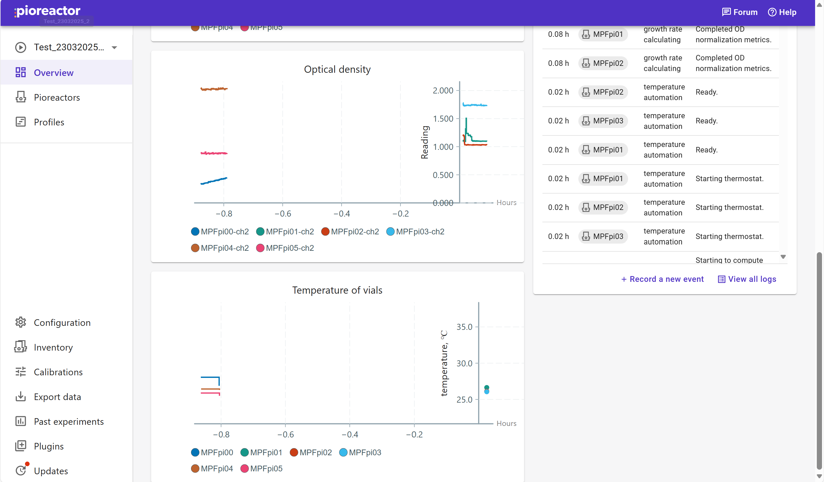

I have just updated all of my pioreactors to 25.2.20 version and after did all calibration. I do have a problem from displaying of logged data from the overview page.
Do you have any idea or how I could solve this.

Hi @Supiwat,

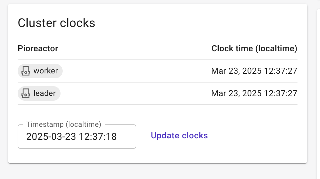

hm, I think the issue is that your worker’s clocks are out of sync. Under the Inventory tab is the Leader page. There’s a card on it that displays the all your Pioreactor’s internal “clocks”:
Do your values here differ a lot between workers?
You can sync them using the card, but I strongly suggest doing this between experiments.
