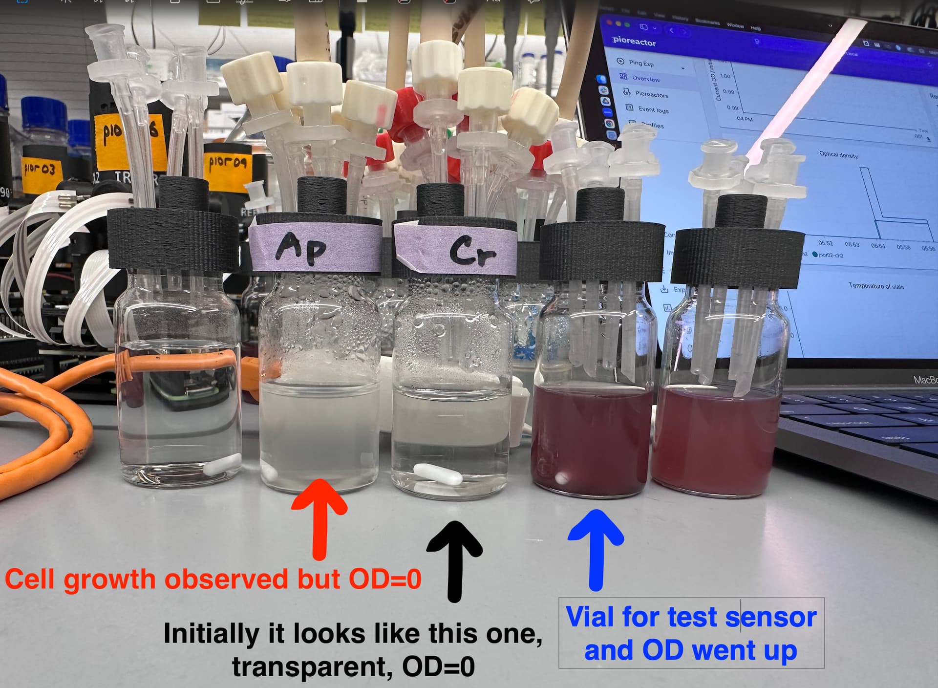

Yes, it is. I started experiment with 10 mL medium + 1 uL cell (it looked transparent at the moment). I set temp: 30 oC, stirring: 800 rpm, optical reading: as default (samples_per_second=0.2, ir_led_intensity=auto), and left for 3 hours, then turned on growth rate function. The next day I found growth rate is off as OD measurement remained 0 all the time (even logs said: OD variance is zero - this suggests that the OD sensor is not working properly, or a calibration is wrong), but when checked the vial, I saw cell growth. When took that vial out and put the other vial (obviously turbid vial), the OD went up.
Attached photo for your reference:
Note very clear, but you can also see on my screen when I reinstalled a software to one of my pioreactors and gave a try. Use vial with black arrow for self-test, put vial with blue arrow, OD jumped up, put vial with red arrow, OD went back to 0. In this set, samples_per_second=0.002, ir_led_intensity=80.
Thanks for your time.

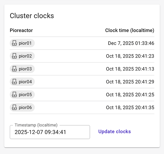

BTW, I think your cluster clocks are unaligned. Can you check visit Inventory → Leader (on the left-hand side), and see if the cluster clocks are different there? You can try to reset them there. Do this outside an experiment.

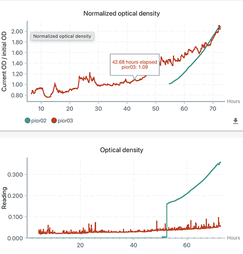

I turned on 1 pioreactor and used a water vial for self-test, then turned on temp., stirring, and OD reading. After a while, I change the water vial to the one with medium + cells, left it for a while, and then turned on LED. The OD seems to be well-functional. Attached for your reference (please look at the green line):
l
I will also test the others and get back to you. Regarding the alignment, I haven’t done it yet as one pioreactor is still running for my labmate’s test with algae culture + 100% white LED. Just wanna know if they can grow. If so, he is going to make a purchase.

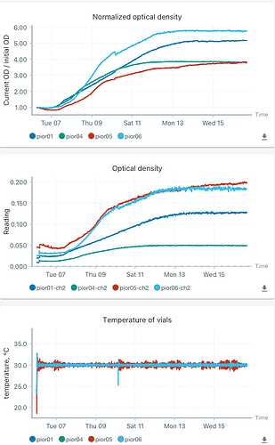

Thanks for your patience. I just tested the other 4, and your hypothesis is right. If I turn on the OD reading a while before turn on the LED, the problem is solve. Please take a look at the following photo for your reference.
  1. During this test, I notice another issue with temperature control in pior5. It seems to fluctuate around and is not unstable as the others. Do you have any suggestion on this?
(Sorry about splitting the post into 2. I couldn’t embed 2 photos in one post)

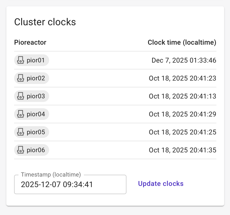

  1. Also, when I update the clock as your suggestion, only the time in leader is updated. The others remains unchanged. Could you also suggest on this matter?
Thanks.
w.r.t. the clocks, we may need to make a software update to fix that. Something isn’t being applied correctly!

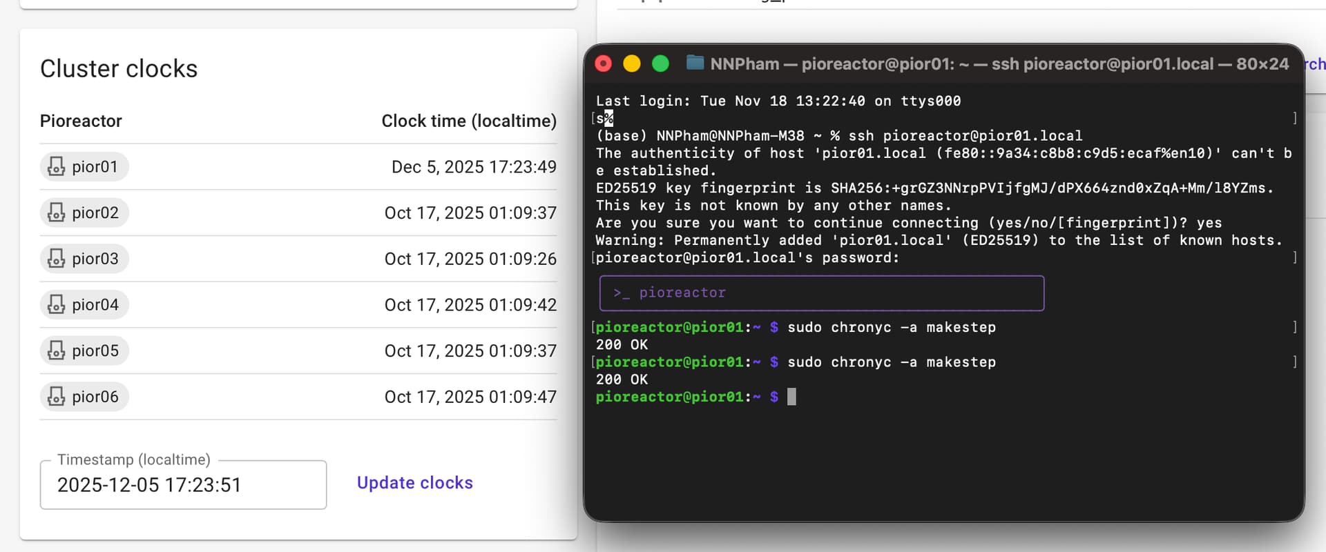

You can try sshing into a worker and running:
sudo chronyc -a makestep
Let me know if that fails!
This might involve a hardware fix later. I’ll do some tests here to see if I can introduce a software fix though.
Thanks, @CamDavidsonPilon,
I run sudo with the pioreactor, but the clock remained unaligned. Are there any alternatives to do it?
