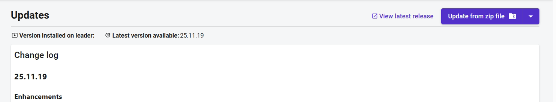

Is it possible that the root of the problem is that the app and the ui are at different versions. My leader and workers are at 25.9.18 and the ui is at 25.11.19. I dont really know how this happened.

the hard-refresh didn’t solve it. do you think that the mismatch of the app and the ui version is the issue here? if so is there a way to revert the ui to 9.18?
So, the ui-version doesn’t really exist - not since the summer. There’s really one a single version now, and the app version === ui version. But you’re seeing differences? Where are you seeing this? (Honestly this kinda sounds like what @gendor was seeing…)
it was there next to the Version installed on leader:
Now its gone because i restarted the leader and everything is gone.
