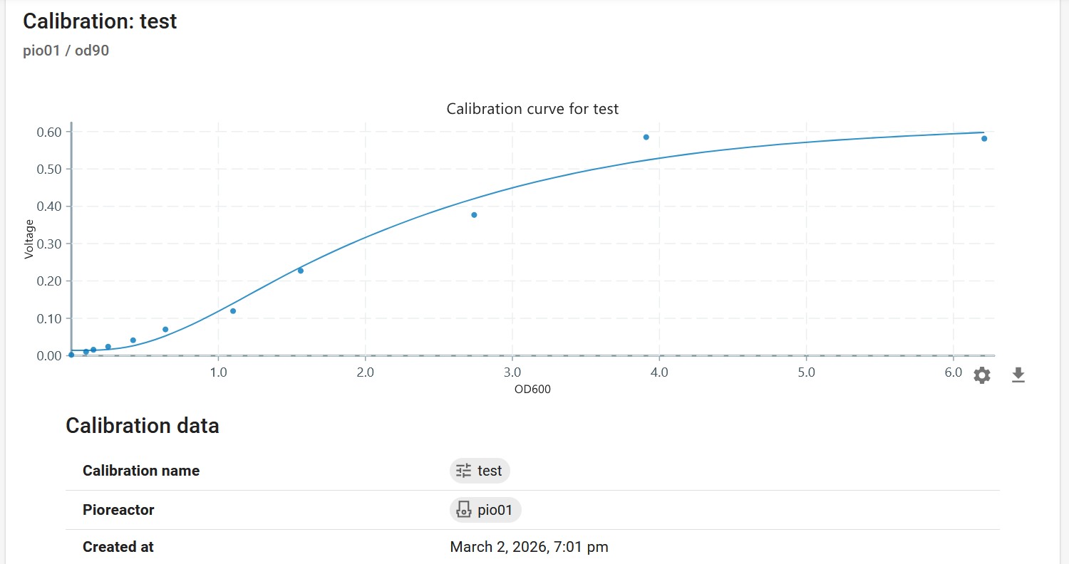

I am currently calibrating the new 40mL pioreactors v1.5 that we ordered. In my previous setup I was utilising the 45 degree angle, as it was the best for high density cultures. However, for these calibrations, I am using the 90 degree angle as I realised there isn’t any space for the 45 degree.
I have ten standards, with Standard 1 being at OD 6.2 and Standard 10 being at OD 0.1. The final calibration can be seen below
I am not sure if I misplaced something during setup, or if this is the side-effect of using a high-density culture in the 90 degree angle.
Any help would be very welcome!
hm, can you check what software version you are on:
pio version
For all angles, there does exist a saturation point where the reported voltages fall with increasing OD (see chart here), however, for 90deg, its usually much higher up than 0.1 OD600.
(45deg was removed in the base kit, but it’s available, and more, in the XR kit)

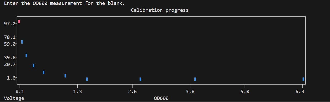

I did another calibration and the 0.1 OD still registers as the highest for some reason…

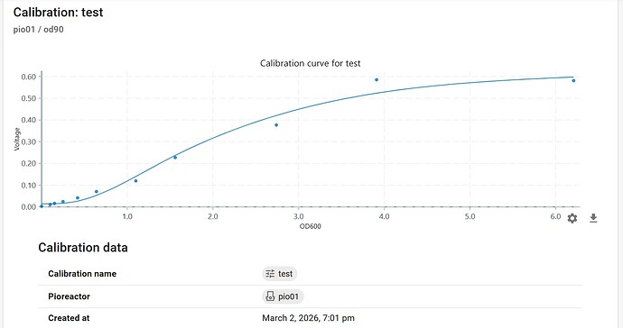

Can you try the calibration from the UI? Calibration → Protocols → choose the pioreactor & device od90.
Do you get the same results? (I’m wondering if the bug is localized to the CLI version)
Hi Cam, yes I got the same results! It mirrors the calibration I made through SSHing perfectly.

AFAIK that update was successful. How turbid is your 0.1? If you dilute it in half, or less, do you still see an increasing signal?
A few other things to check first actually:
- Add (if not present) the following under config
[od_reading.config]:
ref_normalization=unity
- Actually, another thing that might be wrong is the placement of the REF vs 90 eye-spys. This would be consistent with your data. Double check that the eye-spy with the white “mark” in the top-left is in the REF position. Connect the optics system | Pioreactor Docs
Hi Cam!
Yup, I misplaced the white eye-spy in the wrong position! It was in the 90 degree angle.
