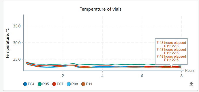

Hi Pioreactor,
For some reason, I am getting multiple readings on the temperature readings at certain points along the redings (so not at all points) after I installed the precision temperature kit. This is slowing down the user interface. When I installed the plugin, it gave notification for fail but the plugin was installed. I tried to reboot the leader but the issue is not fixed.
When I checked the data being registered on the command line, it gave warning with statement that the amount of unregistered data far exeeds the limit defined (or something similar).
Do you have any advice regarding this problem?

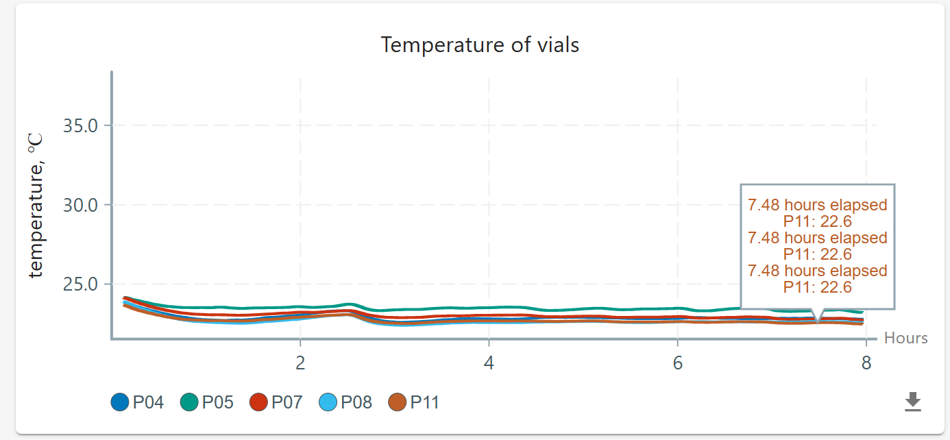

After following the steps, workesr started with multiple measurements but after several values registered, it went to single registry per measurement. However, if I stop and start measurement, it starts with multiple measurement again.
I also tried to re-install latest software and plugim, but this had no effect.
