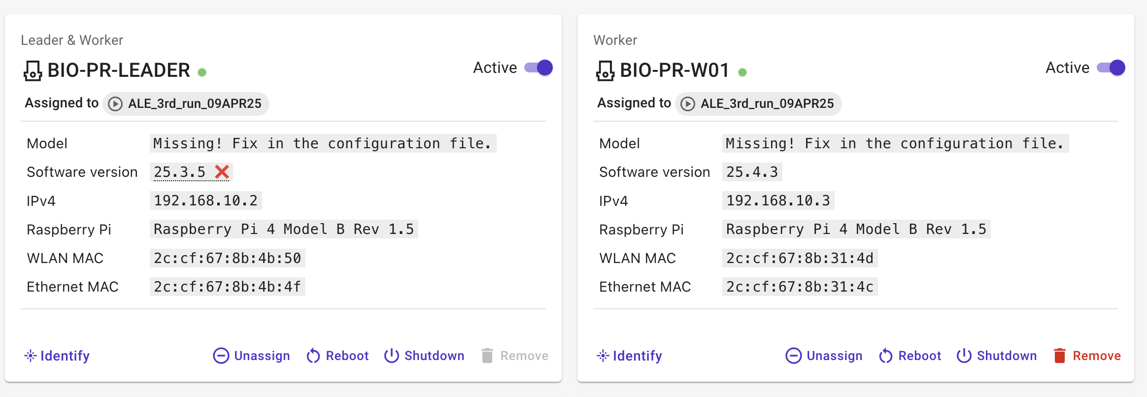

As well, on the inventory page, I cannot choose the model/version of the Pioreactor, and obtain: Model: Missing! Fix in the configuration file

Hi @jb1404,
You’re the second user today who had this issue. Can I ask:
  1. How did you update your Pioreactors? Via the zip file or over the internet?
  2. Can you check what version of UI you have? On the Updates page, hover over the “Version installed on leader” to see.
  3. Do you have a leader-only Pioreactor in your cluster?

-I noticed that the UI version is still 25.3.5. I guess that is why I cannot see the option of updating the model version in “Inventory”. Is there any way to install the UI update via the terminal? I already downloaded the pioreactorui_25.4.3file.
-My leader is a leader-worker.

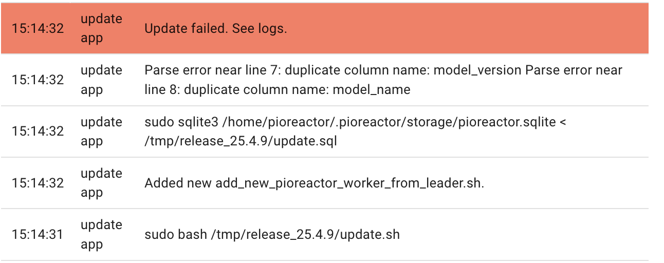

I tried to update to 25.4.9, however, the updates failed as the model and version cannot be recognized, so with the update I obtain the error ’’model_name’’. I tried this in the UI and in the terminal and did not work in either
I tried to update to 25.4.9, the updates failed as the model and version cannot be recognized
But did the update finish? Like, is your software & UI on version 25.4.9?

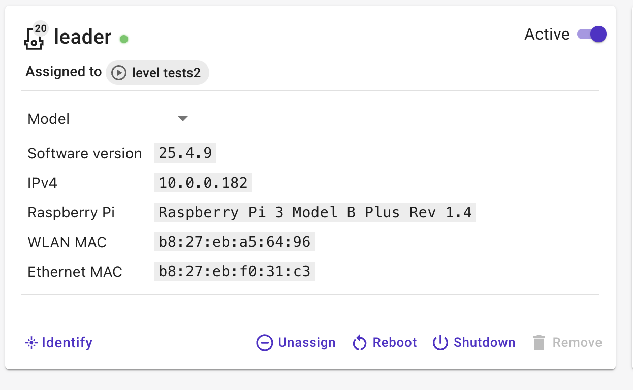

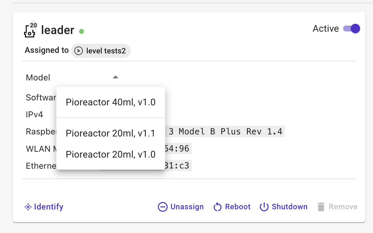

If so, can you check your Inventory page - you might see an empty Model like this:
Go ahead and click on it to update the model:

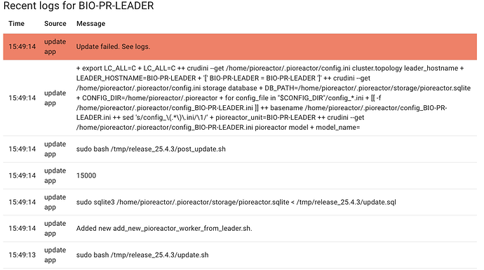

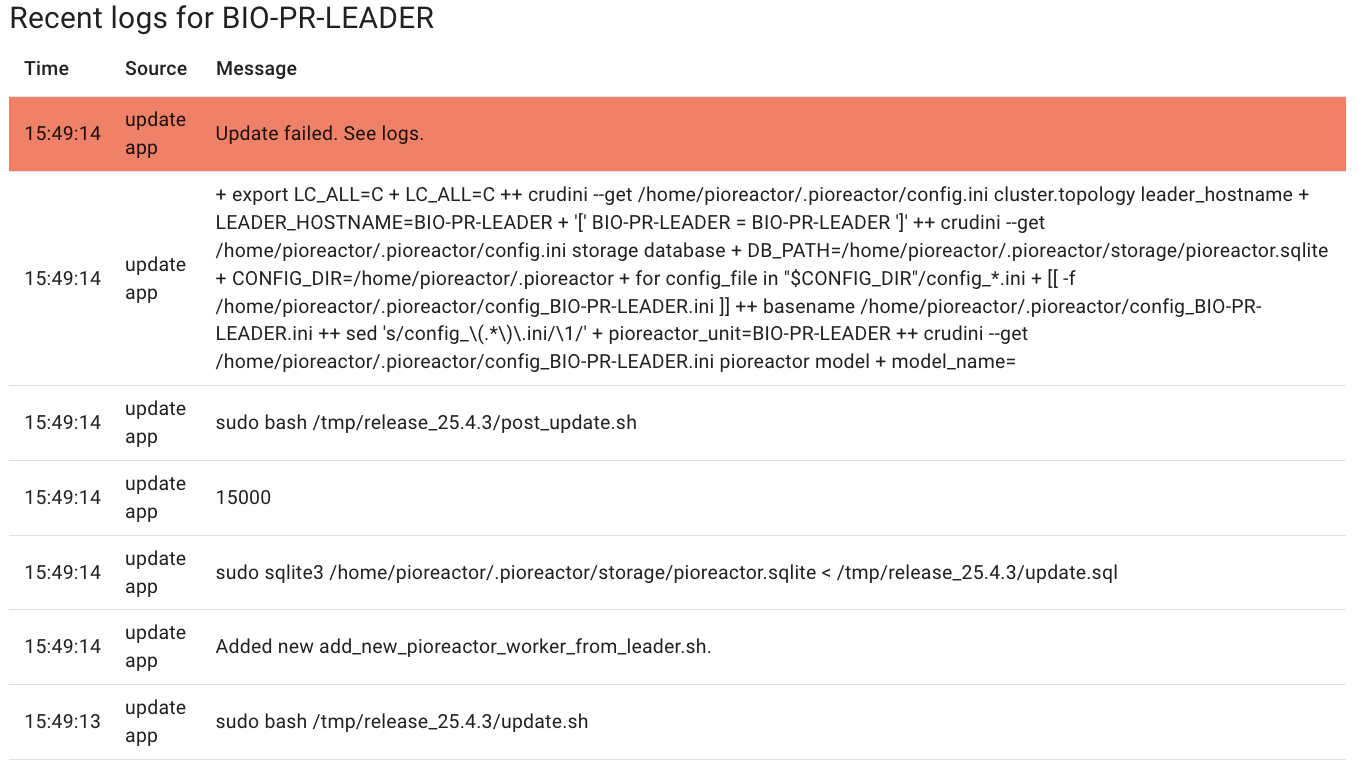

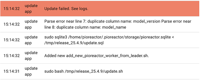

The software did not update. This is what it appears:
I reinstalled the v 25.3.5. again in the leader to see if this solves the issue but it didn’t.
Ah from your logs, I see what’s going on, and I’m able to reproduce it. Give me a moment to figure out a solution. Thanks for your patience!
Okay, here’s an quick & easy answer for you (but for others reading, I’ll provide a better solution via the release code):
  1. SSH into your leader
  2. Enter pio db - this opens up a shell to your database.
  3. Enter
    ALTER TABLE workers DROP COLUMN model_name;
    ALTER TABLE workers DROP COLUMN model_version;
  4. Exit shell with .q
  5. Try updating again.
