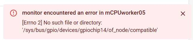

Hi Cam,
Some strange things happened to my cluster after this update:
I have pH probe that is connected to the raspberry pi via usb. After the update, whenever the probe is connected, this message shows:
All my self-tests fail and when I run > version -v, I see firmware 0.0.
Any help on this is greatly appreciated.
Best,
Daniel

Interesting,
I updated via the web interface with the release zip file. This is the log:
(when I plug in the pH sensor, everything crashes, but I have been working with this sensor for months before the update).
2025-05-27T14:01:03+0200 [monitor] DEBUG Pioreactor UI version: 25.5.22
2025-05-27T14:01:03+0200 [monitor] DEBUG [Errno 2] No such file or directory: ‘/sys/bus/gpio/devices/gpiochip14/of_node/compatible’

2025-05-27T14:01:03+0200 [monitor] ERROR [Errno 2] No such file or directory: ‘/sys/bus/gpio/devices/gpiochip14/of_node/compatible’
2025-05-27T14:03:18+0200 [huey.consumer] INFO Executing nohup /usr/local/bin/pio run ph_reading, env={‘EXPERIMENT’: ‘test pH 27_05’, ‘JOB_SOURCE’: ‘user’, ‘MODEL_NAME’: ‘pioreactor_20ml’, ‘MODEL_VERSION’: ‘1.1’, ‘ACTIVE’: ‘1’}
2025-05-27T14:03:18+0200 [ph_reading] DEBUG Init.
2025-05-27T14:03:18+0200 [ph_reading] INFO Ready.
2025-05-27T14:03:18+0200 [ph_reading] DEBUG ph_reading is blocking until disconnected.
This really helps, thanks! I’ll get back shortly with some ideas
We updated a library adafruit_blinka to 8.57.0 in this release, but your error looks identical to: fix compatibility with differing `/sys/bus/gpio/devices/gpiochip*` by mrossington · Pull Request #967 · adafruit/Adafruit_Blinka · GitHub. This was fixed in 8.58.1.
Solution is to update this library again =\
Do your workers have access to the internet? If so, you can run:
sudo pip install -U adafruit-blinka
If no internet, try:
  1. Download the adafruit_blinka-8.58.1-py3-none-any.whl file here
  2. scp to each Pioreactor with the issue. Something like:
    scp /PATH/TO/adafruit_blinka-8.58.1-py3-none-any.whl pioreactor@MY_PIOREACTORS_HOSTNAME.local:~/
    (fill in the blanks though!)
  3. SSH into that Pioreactor, and run:
    sudo pip install adafruit_blinka-8.58.1-py3-none-any.whl
Let me know if you encounter any errors! I may also create a hotfix release this week to address this.
Thanks a lot. This worked!
