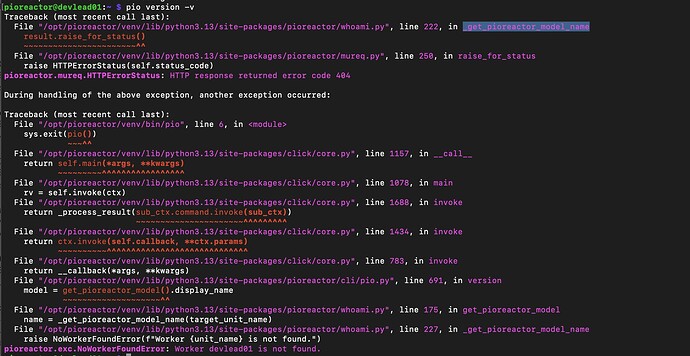

Hi @CamDavidsonPilon ,
We’ve just updated to 26.2.23. We have a leader-only + workers setup. On our leaders, when we run:
pio version -v
We get:
It looks like pioreactor/core/pioreactor/whoami.py at 754ebad2224a9666ab90b126ecfbcee1a50ab183 · Pioreactor/pioreactor · GitHub assumes that leaders are workers also. Would it be possible to fix in the next update you do please? No rush as it doesn’t seem to impact anything else as far as I can tell yet but thought I’d let you know!
Thanks very much
:+1: ty for reporting this - fixed for the next release!

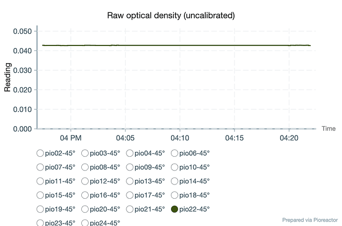

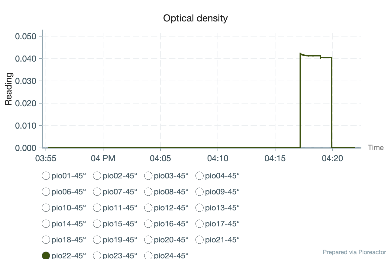

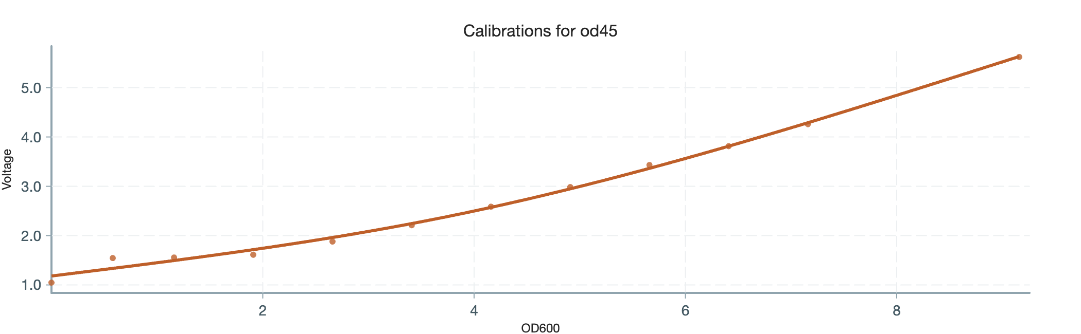

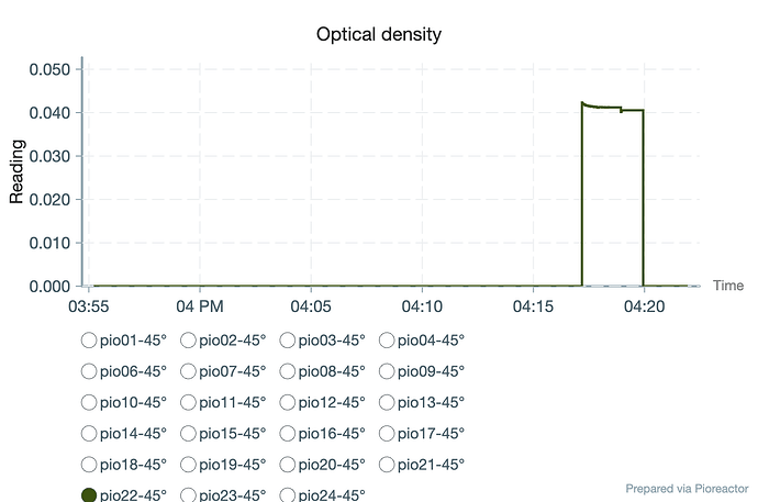

Thank you! Just one other weird thing I’ve noticed with version 26.3.23. For translating my raw od readings to od readings using the calibration, I’m getting a strange bump in the calibrated od readings even though the raw is the same. This was the case for more than just this pioreactor but using pio22 as an example:
I would expect all the readings to map to 0 given that it’s below the calibration curve. Any ideas? I’ll send over data by email.
Many thanks,
Vicky
huh. That “blib” is caused by the self-test plugin that was run (ya’ll have a custom self-test?!) and the plugin is leaking OD readings into the real experiment.
We changed some internals in our self-test - maybe this introduced a problem? It depends on what your plugin looks like. Anyways, the solution is to change the self-test plugin you have, here’s a diff you can use:

Actually, having asked Claude… I was using start_od_reading with the calibration activated and so the clamp_to_recorded_extrema was getting activated:

I don’t strictly need calibrated od so I have copied the use of od_reading in the other tests. I’ll do a check on Thursday to see whether that changes things.

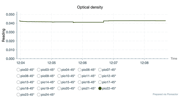

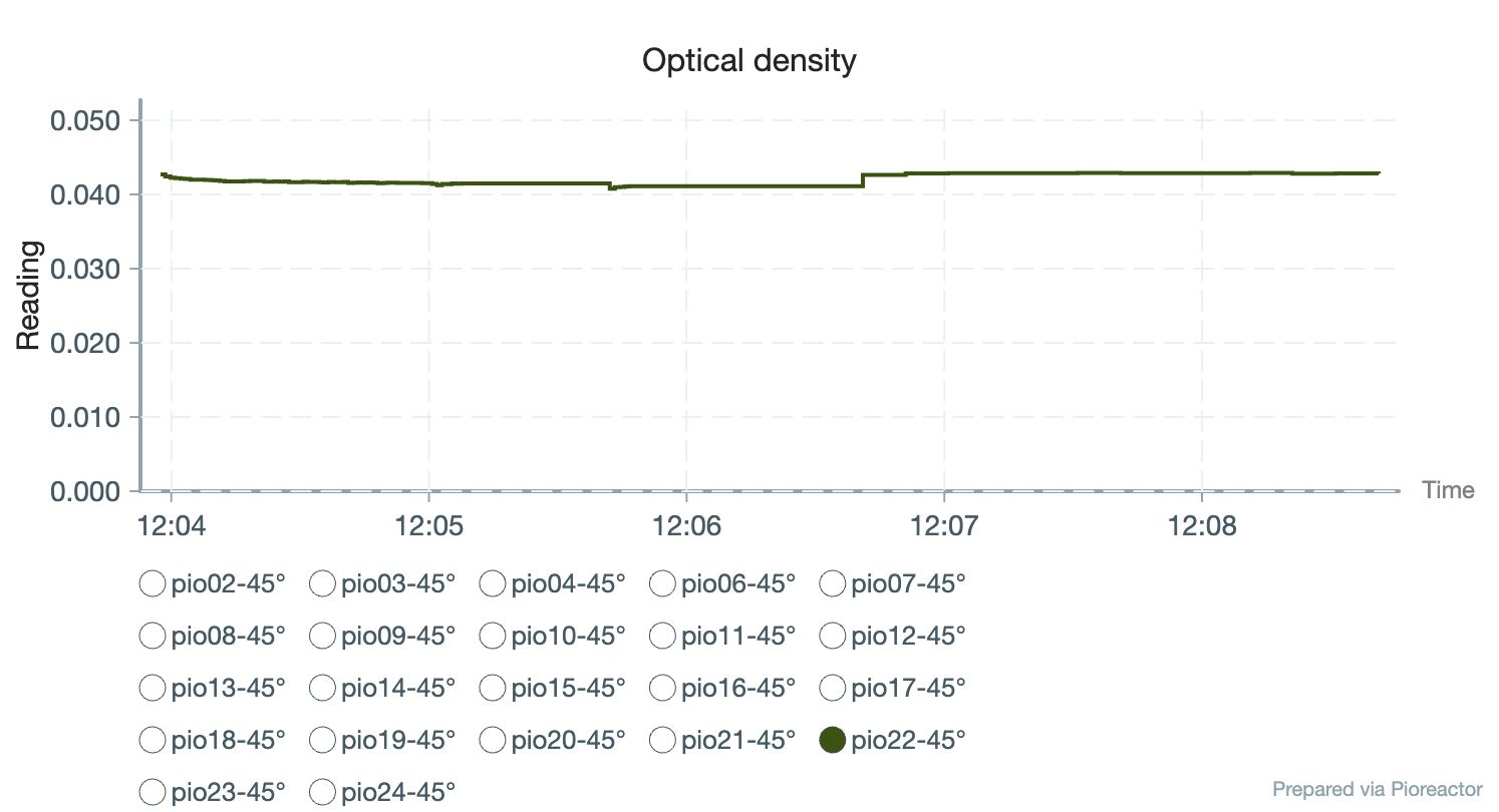

Hello again,

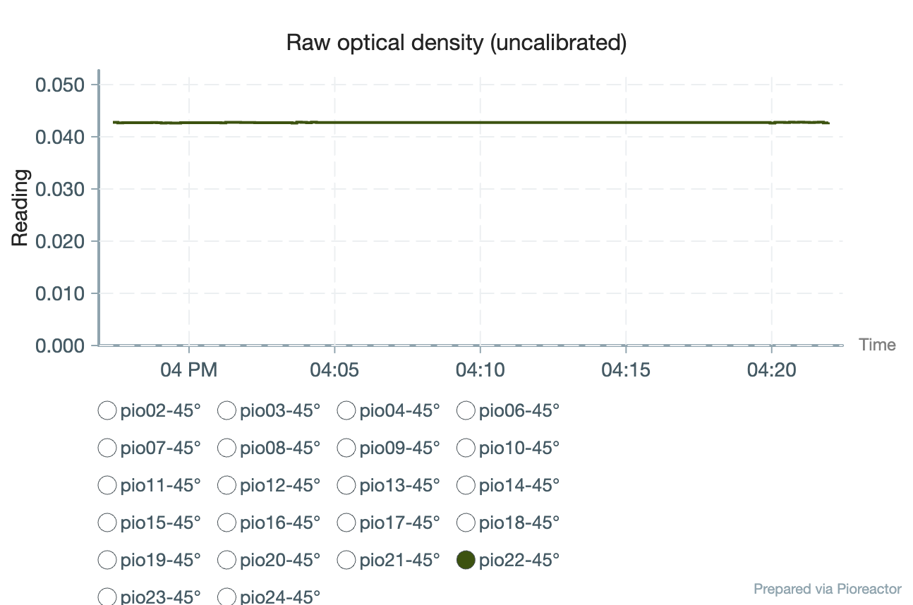

Testing this by running a self-test with the correction above gives me this OD chart for the same pioreactor:
Switching off the calibration certainly makes it look like it makes more sense for the self-test which uses the OD readings job, and looking at the data from before the calibration was active and trimming values below the minimum calibrated range to 0 before and after the blib. Mystery solved!
experiment=self.experiment, was deliberate to assign the data to that experiment. I thought it was working previously but didn’t seem to in the latest test - will investigate.
