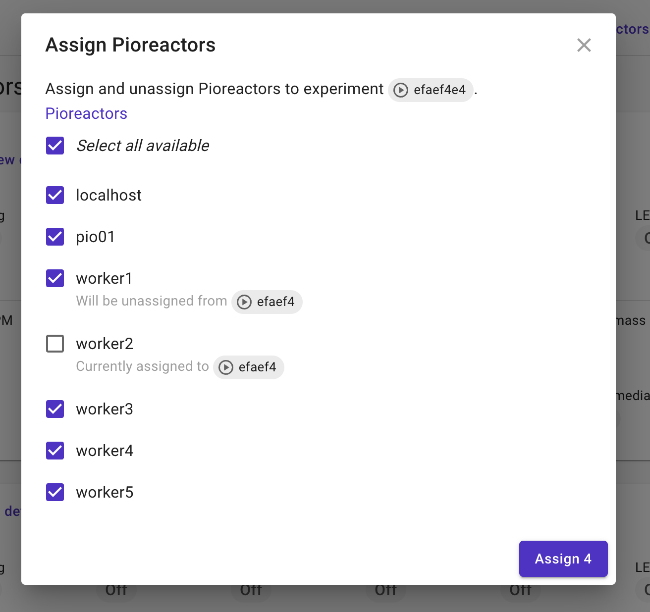

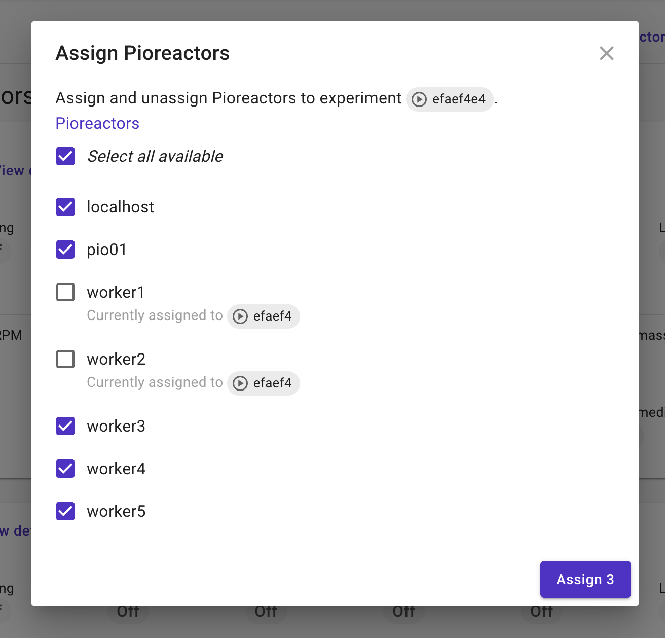

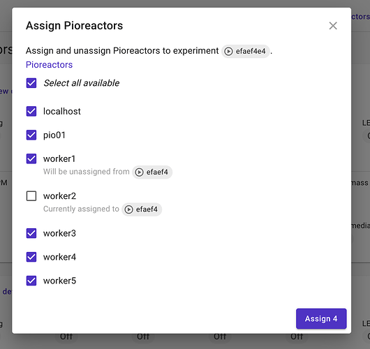

Additional comment on the new feature on v26.3.0 and above. Assign Pioreactors section now allows to select assigned workers. I am not sure what was the incentive for this change, but I think it risks accidental removal of workers from already running experiments in big groups with multiple users. Is there an additional option added to lock the pios?

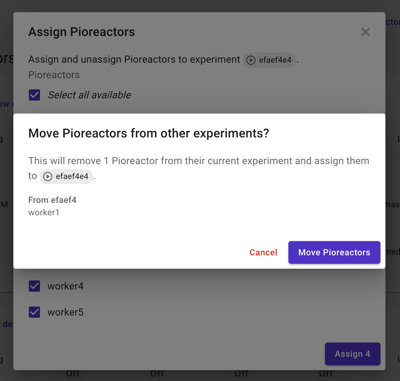

Ah, the incentive was that I felt it was more clear to users. But yes, I agree there is a risk. Maybe we need more cycles “states”.
Let me iterate on this interaction again.

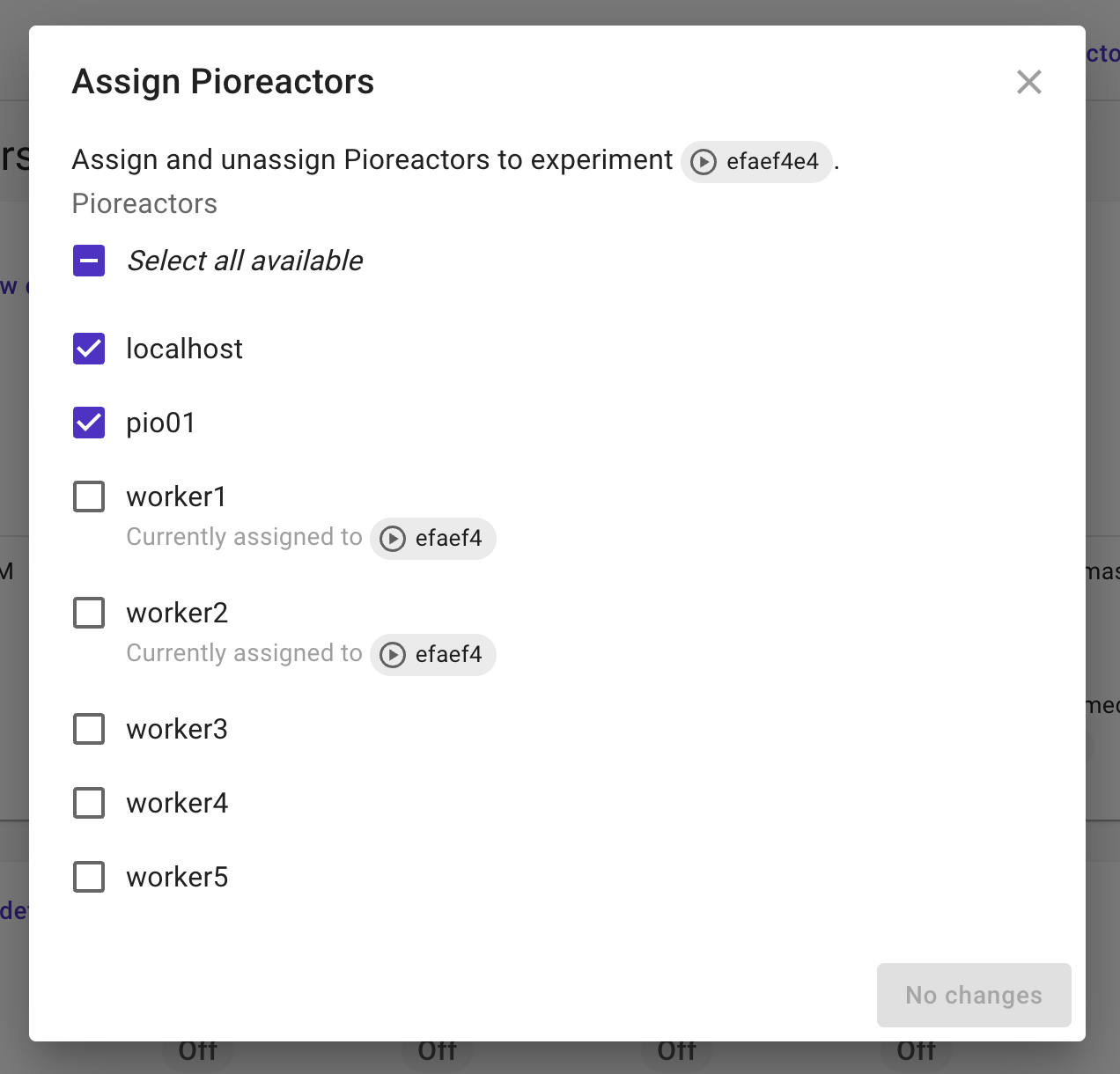

Something like this: “Select all” is now “Select all available” (that’s more clear, and wont select existing Pioreactors), and users can manually reassign.
Maybe I keep the second confirmation, but thats feels like overkill
Yes, I think this is the best of both worlds! I do agree that second confirmation is an overkill as the user is already informed the cause of the action when they manually click on the worker.

  • Adjusted the UI’s “Assign Pioreactors” dialog so Select all available no longer includes workers already assigned to another experiment, reducing accidental bulk reassignments while preserving individual reassignment.
