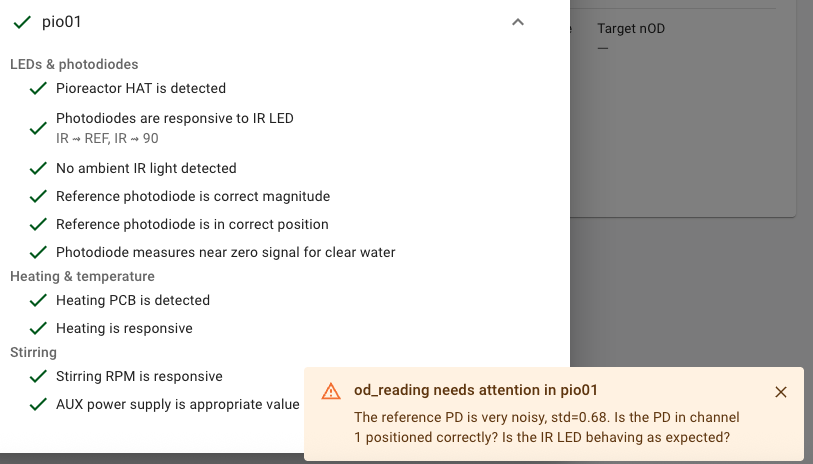

Hi Cameron, I have updated to the latest version. I am still with the 1.1 pioreactor 20 ml. The unity mode very often triggers “The reference PD is very noisy, std=0.33. Is the PD in channel 1 positioned correctly? Is the IR LED behaving as expected?”. Is this to be expected?
@davidhcsic ah! Someone else is private messaging me about the same error =)
Can you tell me two pieces of information:
  1. Did you run a self-test at all? Maybe between starting the experiment → assigning units → SELF TEST OCCURS → start the OD readings job?
  2. If you ssh into the Pioreactor and run:
pio cache view ir_led_reference_normalization
what value is next to your experiment in the resulting list?
pioreactor@pio01:~ $ pio cache view ir_led_reference_normalization
Demo experiment = 0.0002817653
Hi Cameron,
Thank you for the quick reply.
1 - Tests all show as normal.
Using classic and calibrating throung command line solves the issue. If I use the UI calibration I get warnings messages about led intensity.
2 - I have just recalibrated through UI with unity mode and this is waht i get:
intensity**_testing_Demo experiment** = 0.0002402523
I think you can ignore the warning for now. I’ll fix with an update shortly. However, also try starting a new experiment, and reassigning your Pioreactor to that new experiment. (The core problem is that the cache is stuck at 0.0002402523 until a new experiment is used.
