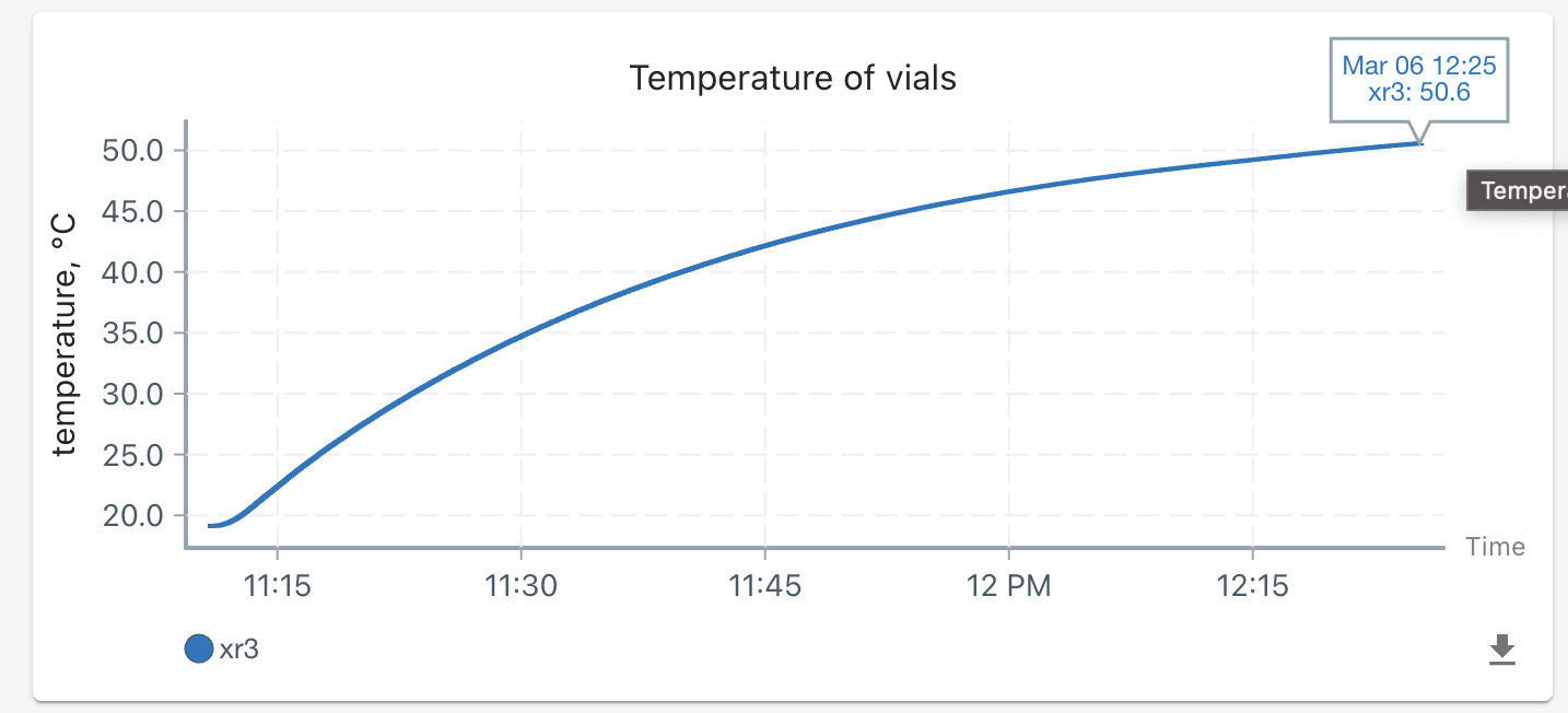

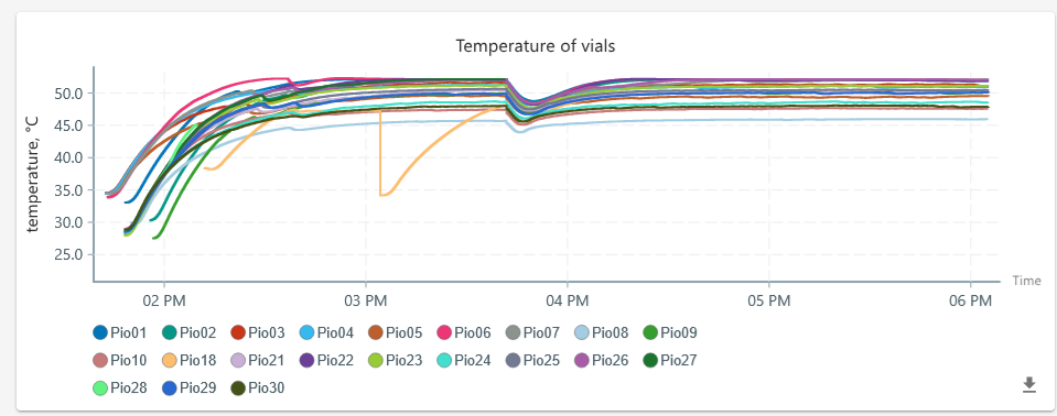

I am trying to run cultures at 52 °C based on your internal tests. But for me it seems like not all pio’s manage this (See picture). I suppose they are max heating but not managing to heat the whole liquid column to 52.
I am using 30 mL in the 40mL v1.5’s. Maybe the fact that its 30 mL is an issue? But you used 25 in your tests, so not that big of a difference? Or maybe room temperature here is a lot colder than it is in Canada ? Jokes aside, I think RT here it is also 20 °C.
Anybody got some suggestions? Maybe something in the hardware installation that gives this difference in heating capacity between units. Contact between PCB, rubber, and vial?
For now I keep using an incubator at around 35 °C and that solves the problem. But it’s obviously more of a hassle with cables, pumps, media, etc…

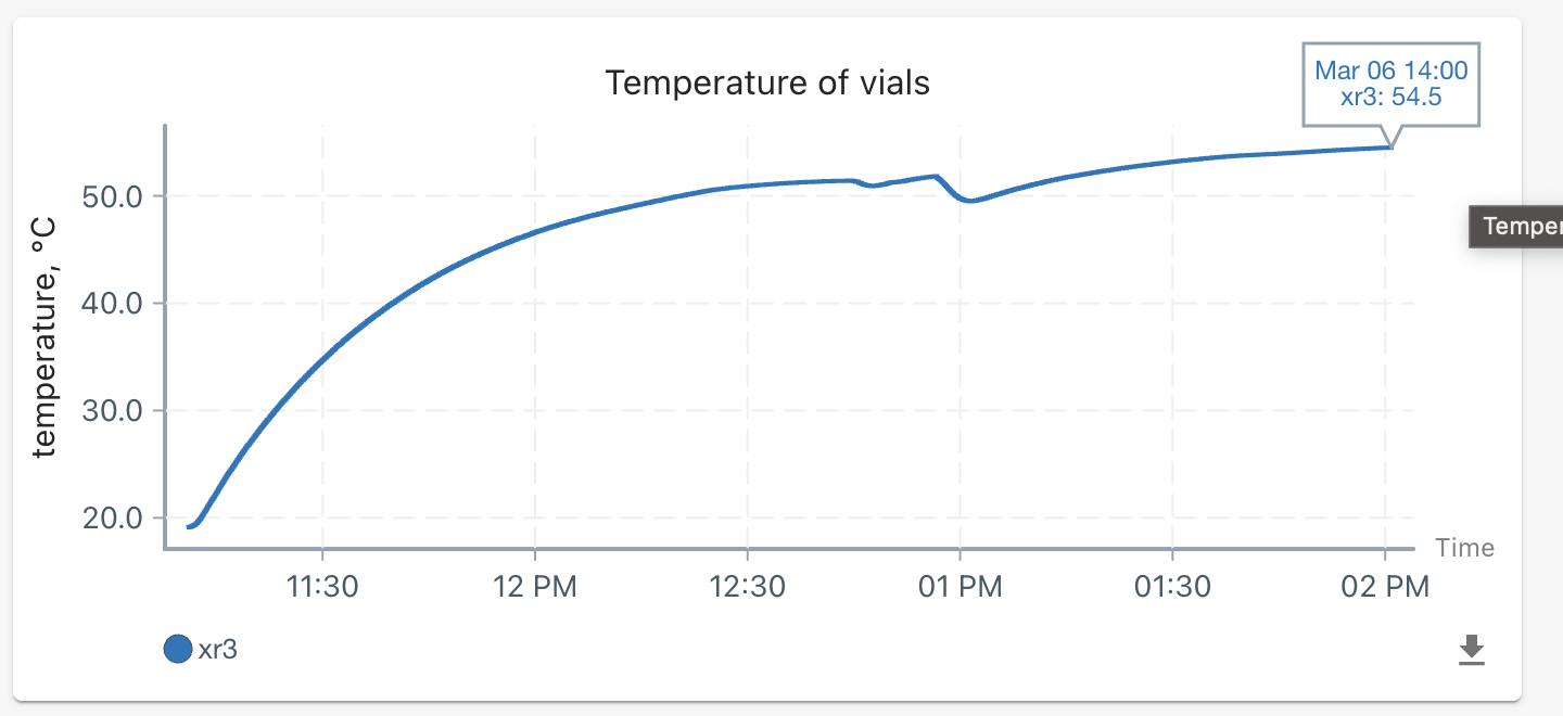

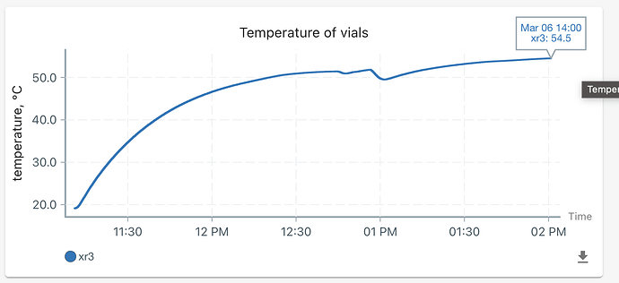

Starting at 19C, it’ll probably stabilize around 51.5C.
The heater does start the throttle when the PCB gets to >= 78C, which is why you see DC% around 80%-100% at the asymptote. There is a small bug here that causes the DC% to throttle too aggressively, that’s fixed in plugin v0.2.9, but I don’t think that’ll significantly increase the top-end.

I’m going to run a few more tests here to see if there are any insulation quick wins. I’m also going to drop the volume from 30ml to 25ml to see what changes, too
Also, perhaps not insignificant (but maybe so), I’m using RPi4s, which do output more heat passively vs RPi Zero 2w

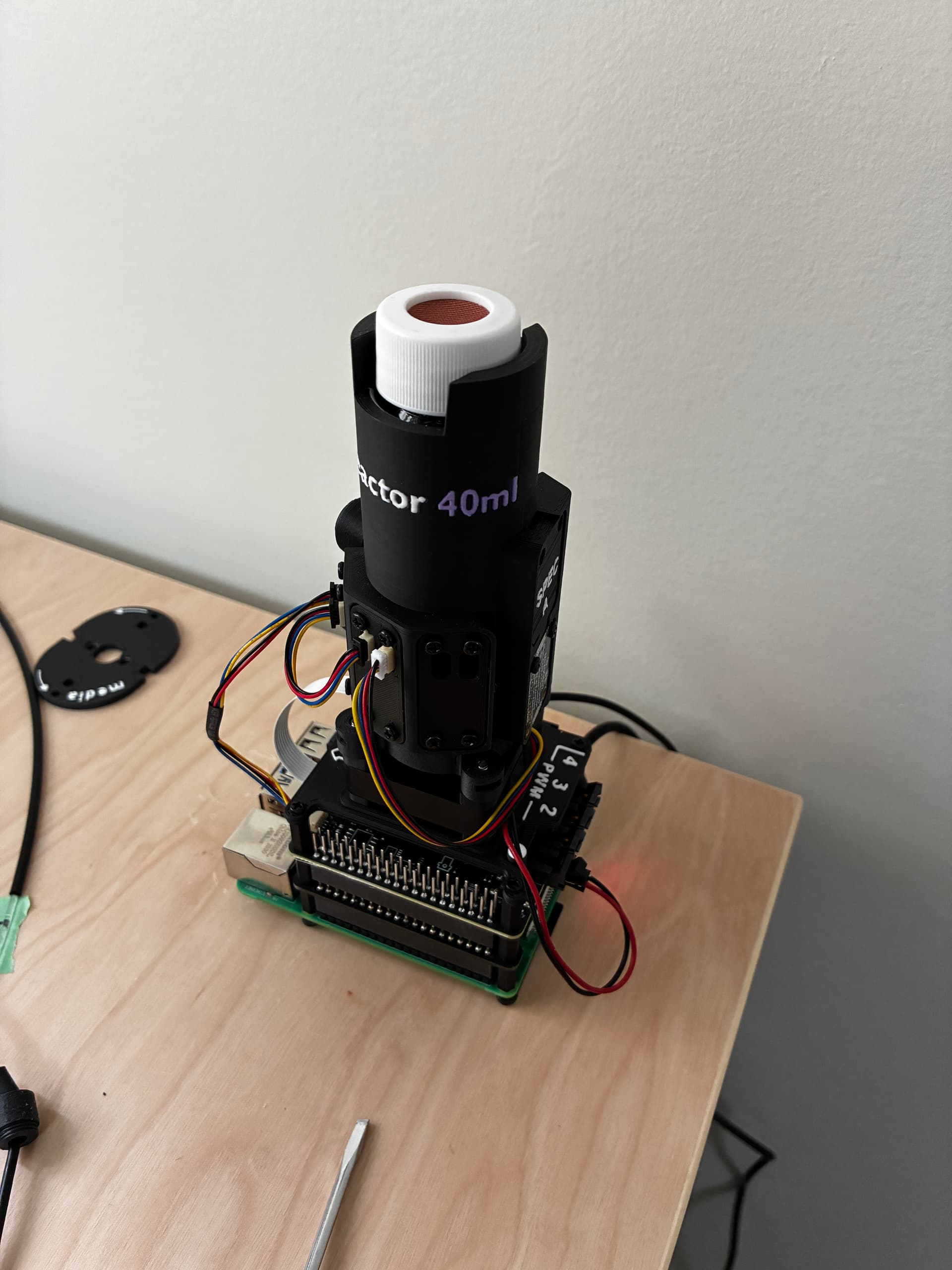

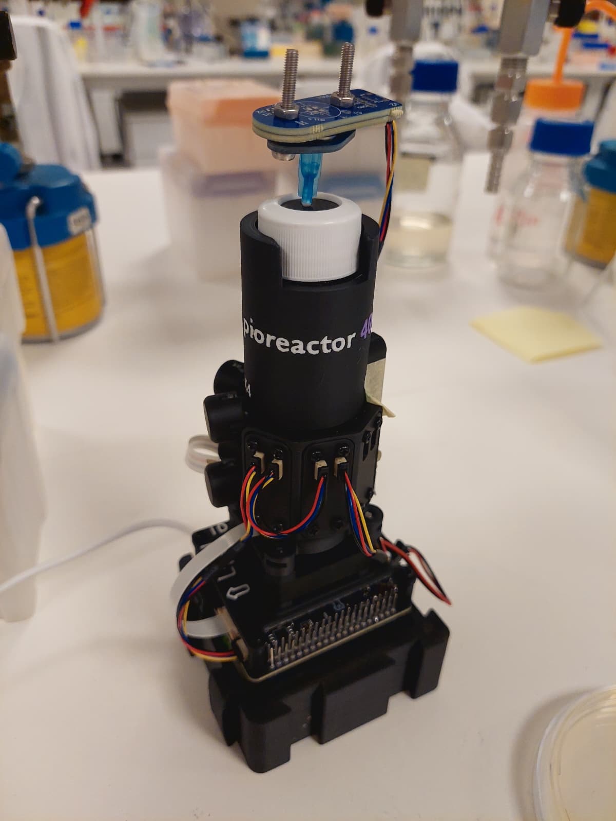

I am using these white lids with a rubber stopper for anaerobic growth. There’s a tiny bit of space between the pio sleeve and the lid. Might that have an effect?
Force the heater to 100%, without throttling. This puts the heater PCB is a somewhat dangerous position - I was measure 81.25C. 85C is truly the limit.
