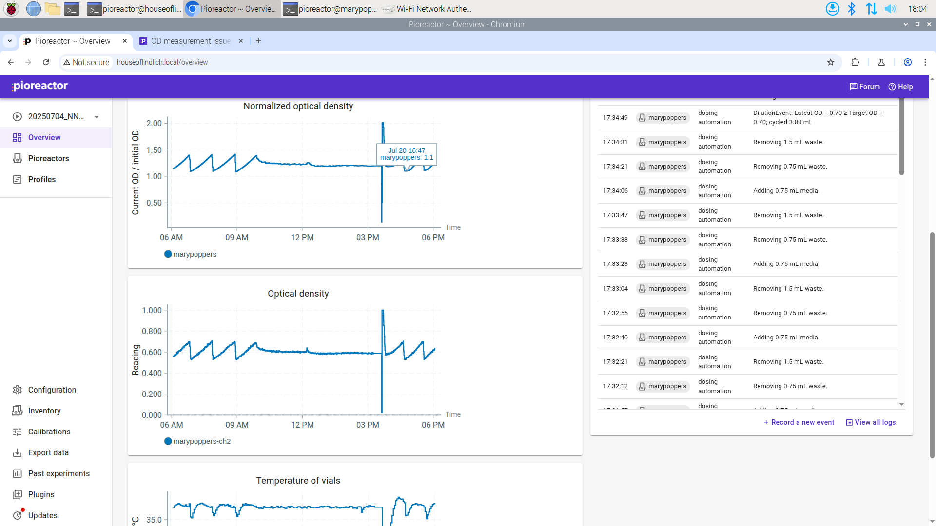

Here is a screenshot of the UI to show the issue:
Basically the OD measurement has been accurate and reflective of real vial conditions until suddenly it isn’t, and the value reading is 0.6 with only a bit of noise. The measurements range from 0.61-0.59. Today I rebooted the reactor at around 15:30 local time and this fixed the issue again, however I worry that these fixes are only temporary.

hm, weird. Can you send me your logs dataset export for this experiment to cam@pioreactor.com?
