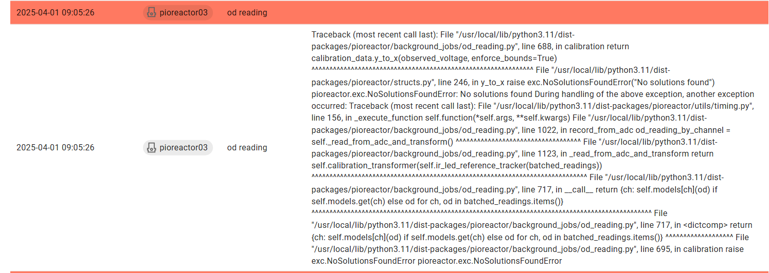

Hi Cam,
Here is what the detailed log states:
That helps, thanks. I’ve made the error message more clear for the next release. For your specific problem, does this error keep coming up in the same OD reading job, or only once (or a few times) when you start?
The error is related to their not being a proper solution for the calibrated signal. Can you share your calibration curve for this Pioreactor (either the fit polynomial, or the raw yaml is fine)?

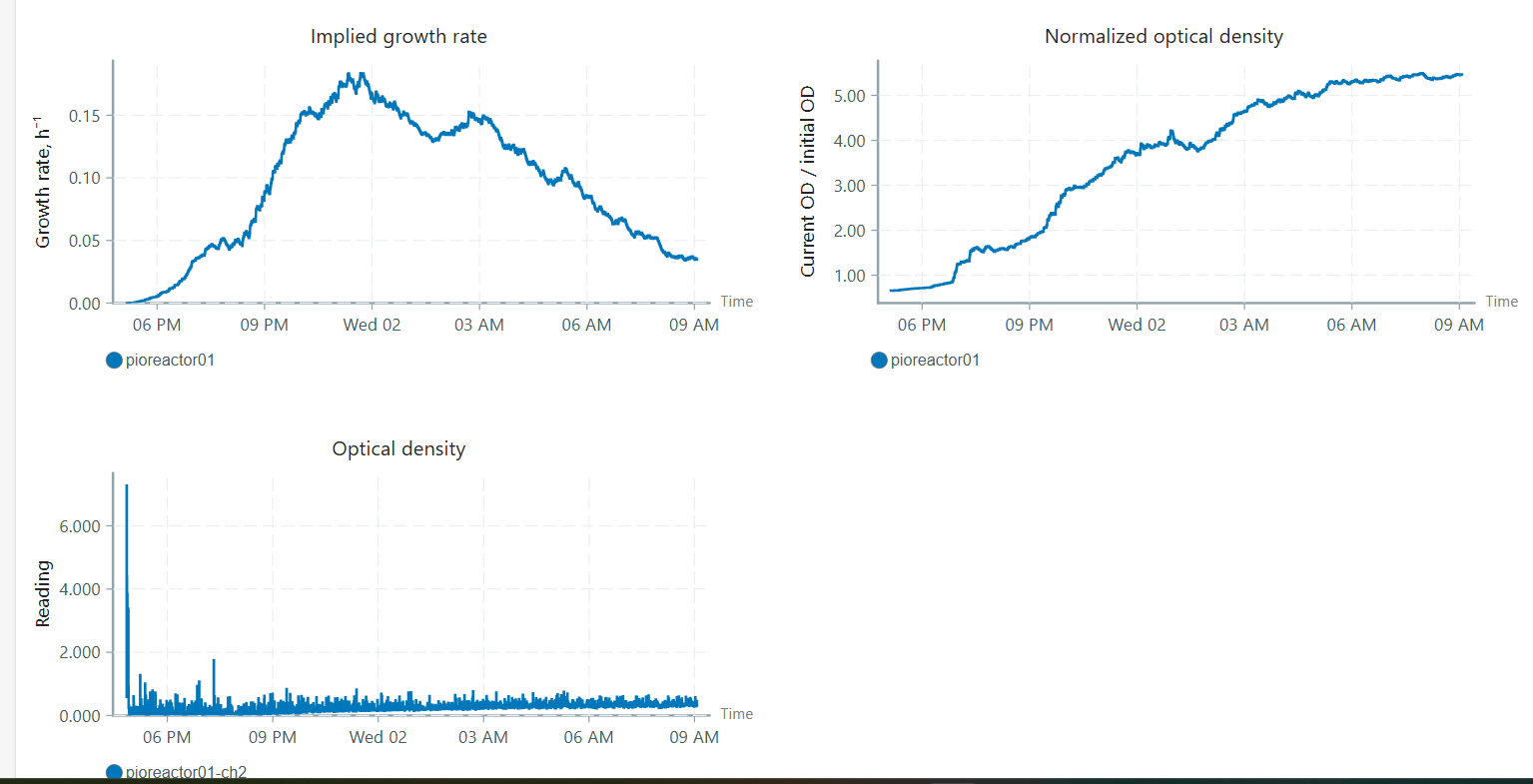

Here are the results from my run last night:
When I began my run, I had the OD calibration for this worker as active, but I kept getting a warning message that my the readings were outside the calibration range (i.e. that the voltage readings were too high for my calibration), I wasn’t entirely sure of why that occurred, so I turned the calibration as inactive for the run just to see if I could get some data. The nOD looks fine but the actual OD graph is a bit wonky.
Yea I don’t love it. When you turned set the calibration to inactive, did you restart the OD Reading job? If not, the job will continue to use the calibration. (This isn’t clear to users, and I should make it more clear one needs to do this).
The OD readings are pretty noisy. A few things to help debug:
  • is your stirring RPM high?
  • any “floaties” in your culture (aggregates of cells, or proteins)?
  • is the Pioreactor near a source of lots of EMF? (like a big electrical machine that’s always running)?
I may have just paused the OD reading when I turned off the calibration. I typically run the experiment at 350 RPM but when I began the run yesterday I was having stirring issues with the stereotypical message of RPM is 0 or something along that line, so I ended up changing the use_rpm to 0 to allow the stirring to continue without a “target RPM”. There wasn’t anything floating in my culture when I looked at it this morning, so I’m not sure that’s effecting it. The pioreactor is currently on a counter that is adjacent to a fume hood, but other than that, it isn’t near really any other equipment.
Hi both,
Just to add few other options to
  • Having Pioreactor close to window on a sunny day
  • Having Pioreactor window open and exposed directly to sunlight
  • Having stirring bar thicker than the original Pioreactor bar
Can also introduce additional noise to the OD readings based on our experience.
