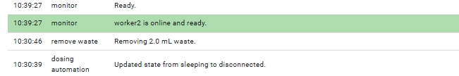

My dosing automation Paused. One of three pioreactors have this problem. It added more liquid but not remove it. I removed the extra liquid but the system can’t not restart again.
I have solved the problem.

Hi @Martin1, there are a few ways to solve this. Can you describe what you are observing or trying to accomplish?
Generally, that warning occurs when the software thinks that the volume in the vial is too high (in actuality, it may not be accurate).
This warning often occurs when running a dosing automation like chemostat or turbidostat, and a user adds more media via the UI, and now the volume is larger than expected.
The limit of 18ml is hardcoded (in the latest software) for Pioreactor 20mls. We don’t suggest going above that for safety reasons.
