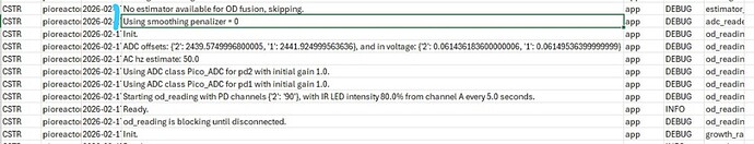

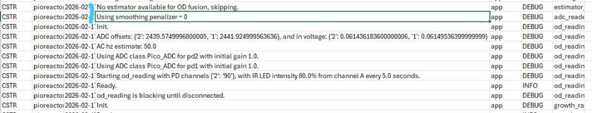

Also, my OD measurements seem to be incorrect. Based on the logs, it looks like the system isn’t using the calibration at all. I checked the calibration settings, and the calibrations are marked as active. I am attaching picture of the log. (This happened when the pioreactor version was 26.2.3)
I am also not able to access the config.ini through UI.
Can you check a few log lines above - a message about calibations would show up just prior to your screenshot (either “No calibration available …” or “Using OD calibration …”)

I’ve attached the experiment log file here. Could you please check why I’m getting incorrect OD measurements?
log.csv (325.4 KB)

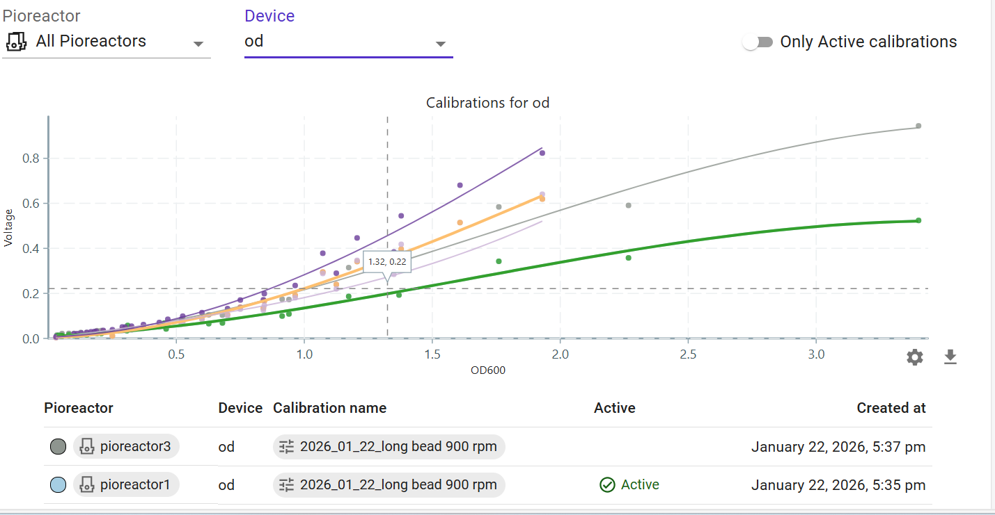

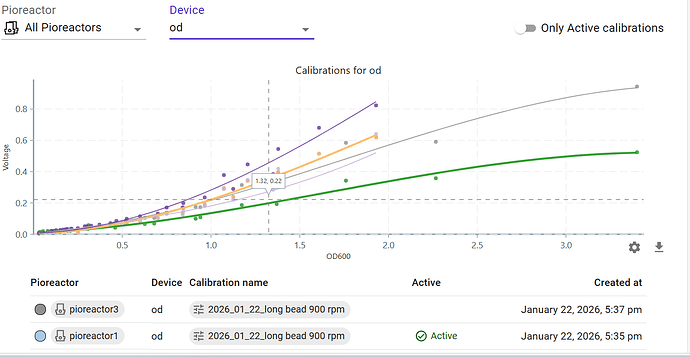

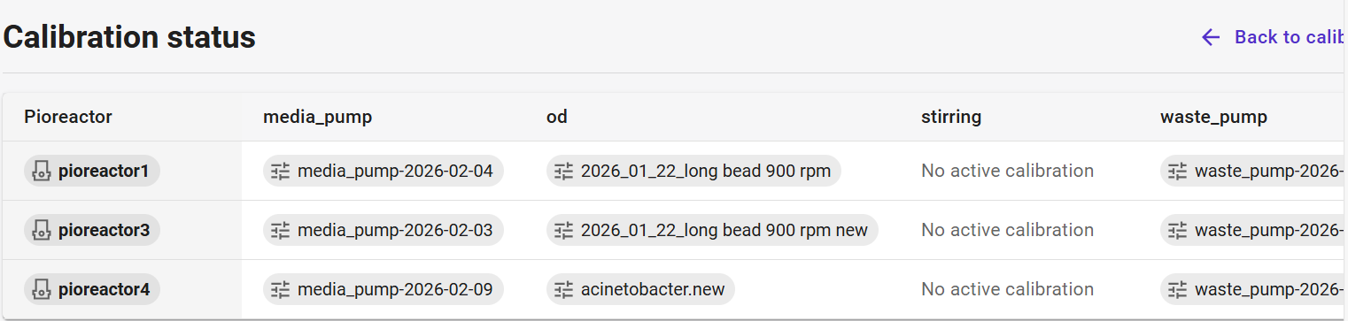

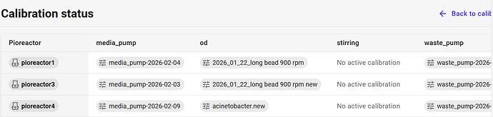

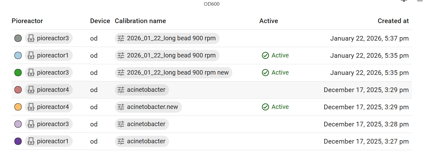

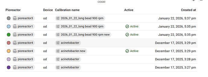

There was an important change in 26.1.30 that may not have been applied in your cluster. On the Calibrations page, do you see under device values od, or od90?
I have attached the screenshots. I have also attached the calibration file, in case there is something wrong there.
calibration_yamls.zip (39.4 KB)
Right, okay, some important migration wasn’t applied in an update. From the changelog:
  • OD calibration devices are now per-angle (od45, od90, od135) instead of just od. Physically, this changes the calibration directory in ~/.pioreactor/storage/calibrations/od to ~/.pioreactor/storage/calibrations/{od45,od90,od135}. Existing od calibration files and active calibrations are migrated during the update.
During the update to 26.1.30, a script bundled with the update should have been run your Pioreactors, but it did not.
Can you try downgrading your cluster to 26.1.30:
pios update app -v 26.1.30 -y
This will re-apply the patch to change od to od90.
(UI will not work, that’s okay, see below. If you need to see it, try sudo systemctl restart pioreactor-web.target on the leader)
then, after a few minutes, re-upgrade the cluster:
pios update app -v 26.2.23 -y
