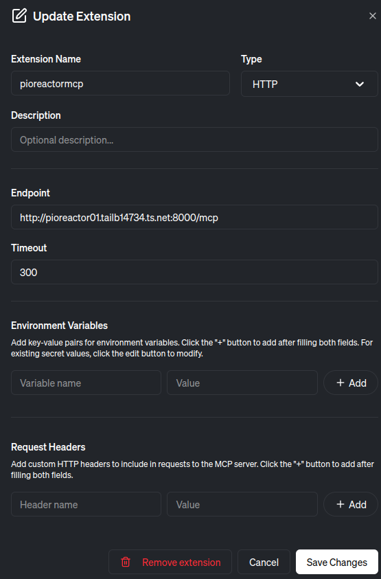

With Claude’s help I have an MVP of the MCP server running as a plugin on our pioreactor. You can use an MCP client like goose to connect to the server and access the tools/resources. Repo is here: GitHub - Change-Bio/pioreactor-mcp
You’ll need to forward port 8000 over tailscale:
sudo tailscale serve --bg --http 8000 --set-path /mcp http://localhost:8000/mcp
Then you can use the tailscale address with an MCP client/host. In my case the goose settings look like this:
Future steps are to add more tools/resources, make sure there are safety features embedded, and add some kind of MCP client/host locally on the pioreactor so there can be a chat window in the UI. The latter isn’t a priority for us as we’re happy connecting over tailscale but would make it much more accessible to people. THe local MCP client would just connect to localhost:8000
