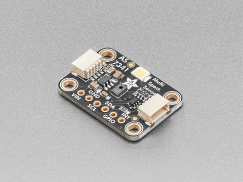

The blog post also mentions there’s a dedicated slot for a Adafruit Spetrometer board - is that this model?
Just curious what the use case for that is?
Yes, that’s the correct model in mind! It can be used for measuring culture color, and later, culture fluorescence.
