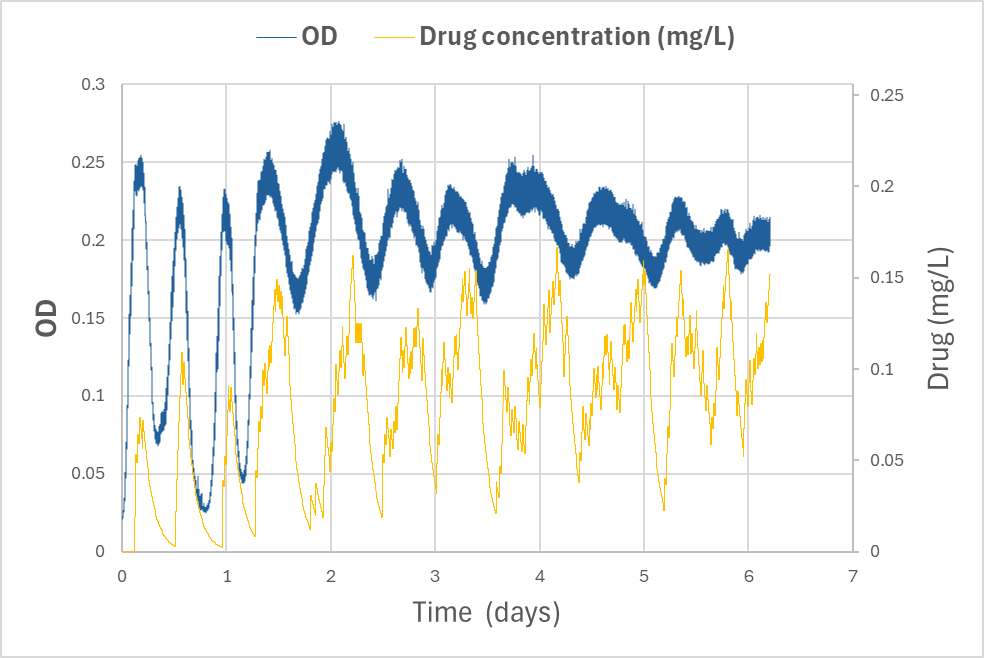

Our group mainly work with pioreactor in morbidostat mode. After export data, we usually calculate the drug concentration in vial over the experiment time, plotting as this:
Drug concentration in vial is calculated taking into account the dilution events with media or alternative media, the initial drug concentration in the vial (C_vial_initial) the volume of the vial (V), the volume of the addition (ΔV) and the drug concentration in the reservoir (C_reservoir) as follows:
Would be possible to implement it in following releases?
