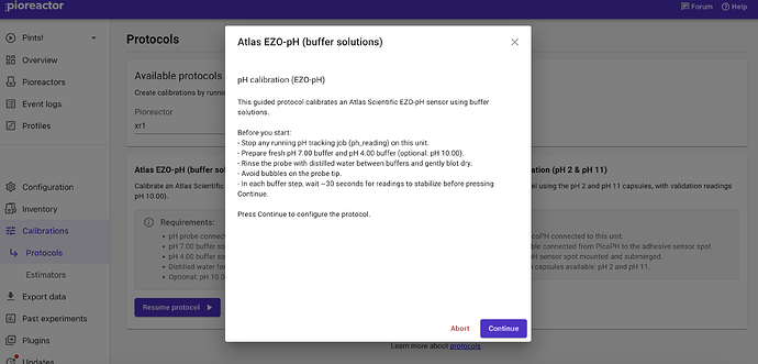

I’ve built a custom pH calibration protocol as a plugin (using CalibrationProtocol + SessionStep and ctx.executor(“ph_ezo_cmd”/“ph_ezo_read”)), and I’m seeing a reproducible issue in the UI Protocols flow.
  • Environment: latest Pioreactor OS (updated early March 2026), Atlas EZO-pH on I²C, plugin modules under ~/.pioreactor/plugins/.
  • Expected: After boot, I can go straight to Calibration → Protocols → pH calibration, run it, and steps like “Clear existing calibration” send commands over I²C via the executor actions.
  • Actual:
  • If I go directly to the pH protocol after boot, the session hangs on “Clear existing calibration” (spinner never finishes), and no I²C traffic appears on SCL/SDA (verified with a logic analyzer).
  • If I first open the “Plugins” tab in the UI, then go back to Calibration → Protocols and run the same pH protocol, everything works: “Clear existing calibration” completes and I²C commands are sent normally.
  • Hypothesis: plugin modules that register calibration actions (e.g. ph_ezo_cmd / ph_ezo_read via ctx.executor) aren’t imported / registered in the worker until the Plugins page is opened, so the executor has nothing wired up when the protocol is run right after boot.
Is this a known issue with plugin-based calibration protocols? And is there a recommended way to ensure plugin calibration actions are registered at startup so Protocols work without having to visit “Plugins” first?
