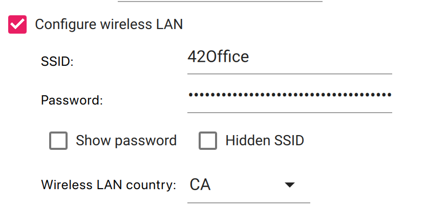

There was a OS update in releases after 24.10.28. We updated the base Raspberry Pi OS to version 2024-11-19, and there were some change to wifi in that OS update. Notably,
  * rfkill and NetworkManager defaults to blocking all devices by default
      - On-board adapters devices are whitelisted
      - WLAN devices are unblocked after the regulatory domain is set
This means that the “Wireless LAN country” must be set in the Imager before writing the image, or wifi won’t turn on:
Do you think that’s the issue?
I don’t think so, sadly, we by default set that to DK.
But I will check again with my colleagues tomorrow.
