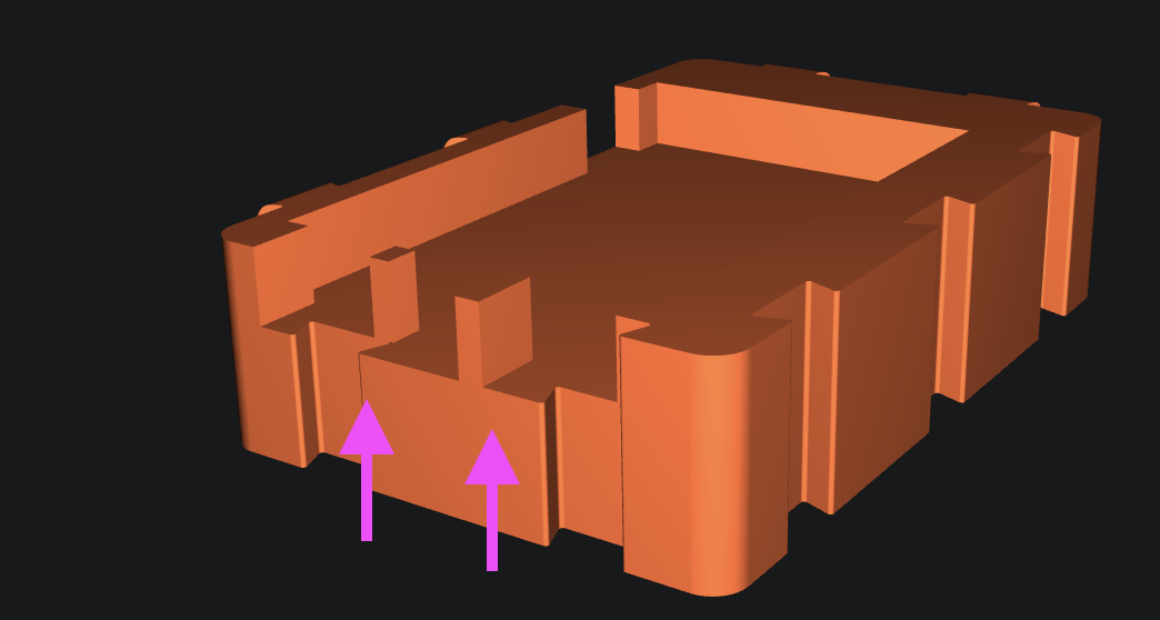

For example, if the ethernet is pulled, or if the dovetail is moved but the ethernet is stuck, the Pioreactor would slip off the platform?
There are two older models for the platform here: https://www.printables.com/model/679663-pioreactor-platform-with-dovetails-for-b-models/files
The first one doesn’t have an ethernet cutout, so it can’t be used. The second one has an ethernet/usb cut out, but the “stands” kept snapping off so we simplified the design to remove the stands.
There isn’t a design that securely attaches the Pioreactor to the platform. We’ll consider it for a future version though!
No it’s actually different.The ethernet cable is a sturdy one so when plugged in it might actually pull the entire pi + reactor up into the air above the platform. If we could attach the pi/reactor tot the platform we could think of a way to stick the platform to a setup below it.
but as it is now we have a flying reactor due to these cables.
