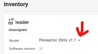

Solved.
With help from a coworker we realized the Model drop down menu wasn’t selected and must have reset to blank while we were working with the software in replacing the HAT I guess.
Thanks Cam for the speed response
I think in the newer software versions, there is a catch for this. But thanks for letting me know the solution!

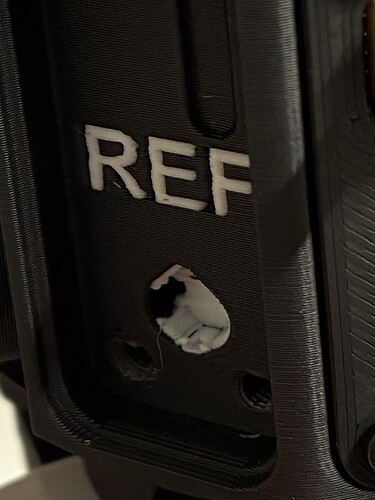

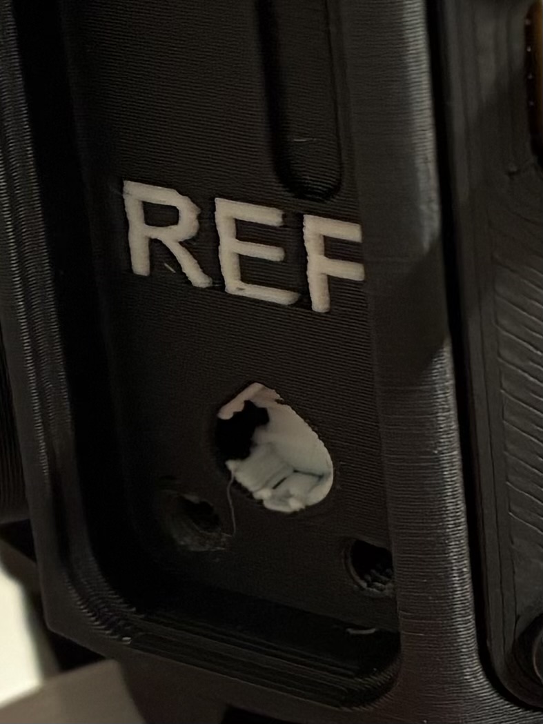

  2. Ensure optical path is clear. It appears to be clear however around the REF board hole there is white filament is this supposed to be there? Have attached image below.

Oh I figured it out. There was a bug in this test for v1.5s. I’ll fix shortly. You can very likely carry on even with this self-test failing.
You can try updating to the (just released) 26.2.26 release. It has some other bug fixes too, along with better self-tests.
