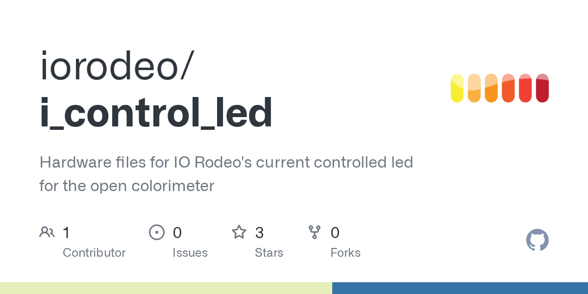

IO Rodeo is still actively working on a controllable LED board - their GitHub repo is here:
@noahsprent They’ve asked that you get in touch with them directly.
