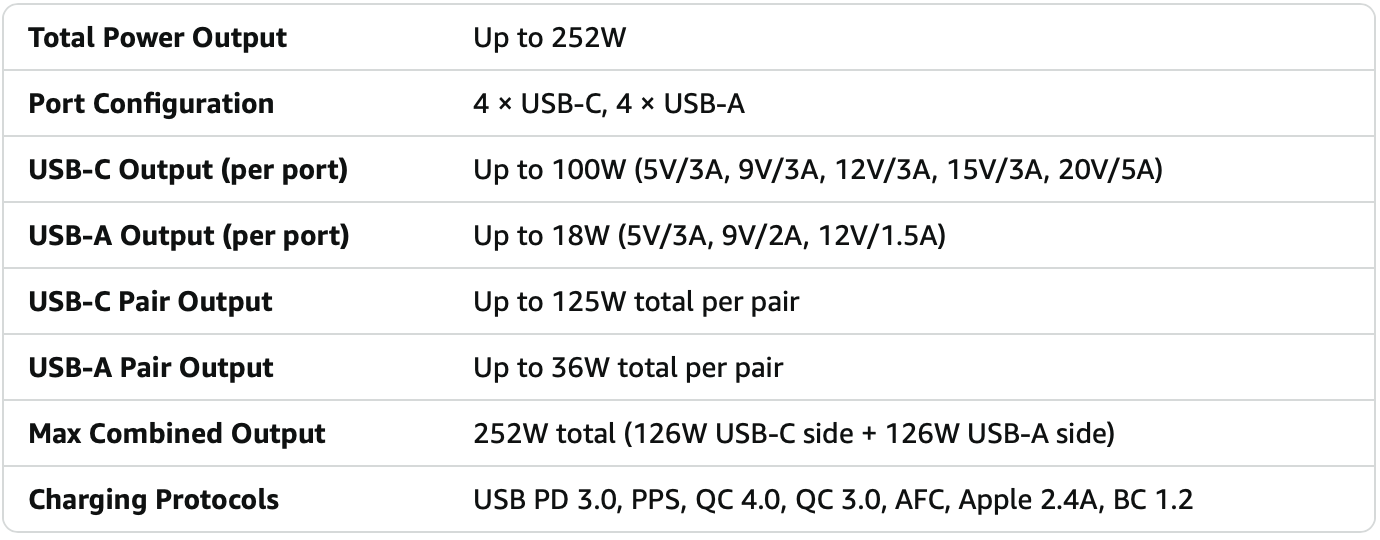

Hey Y’all, so I just wanted to update again on another great power supply I have found, and that our lab is currently using.
Sabrent Power supply for 4 pioreactors
This power supply unit is pretty much perfect for building clusters that I could find. Both USB A and C ports support 12V, and there is plenty of wattage to go around.
The specs are below for y’alls convenience.
