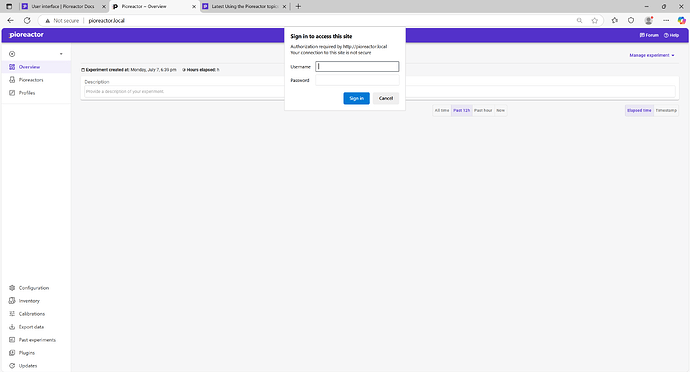

Hello,
I’ve been having some trouble with the Pioreactor recently that led to me eventually uninstalling all my plugins and all restore the Pio. to the previous version, 25.6.25. I’ve fixed the errors that stopped my systems functionality. But now when I try to access the UI I get the following prompt.
You probably installed the basic-auth plugin. To fully uninstall this (and we should do this for you), run the following on your leader’s command line:
sudo lighttpd-disable-mod basic-auth
sudo service lighttpd force-reload
You are so right, I just realized this as I made this post. Thank you for the quick response.:+1:
