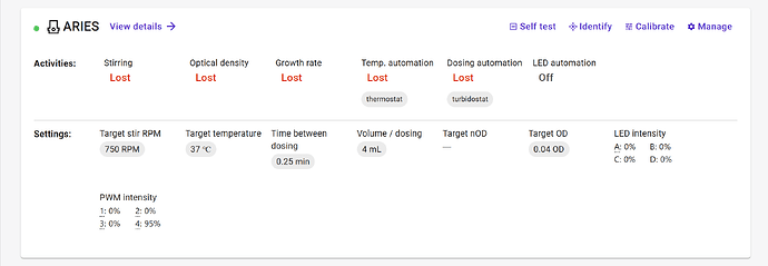

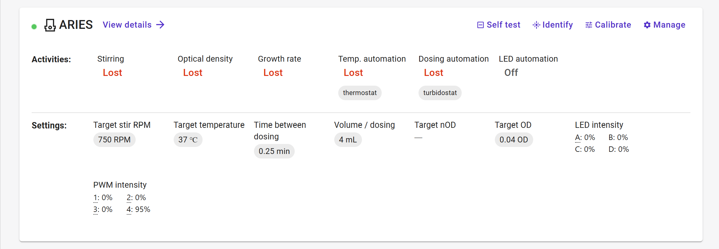

Furthermore, the message displayed is not that the worker is fully “disconnected” it just prints “lost” in front of all automations that were running before it lost connection. Also it is running an experiment profile on the side of the automations and this one keeps working even whilst the automations are “lost”.

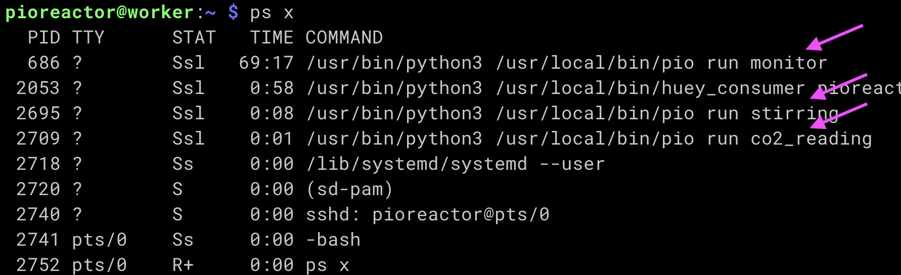

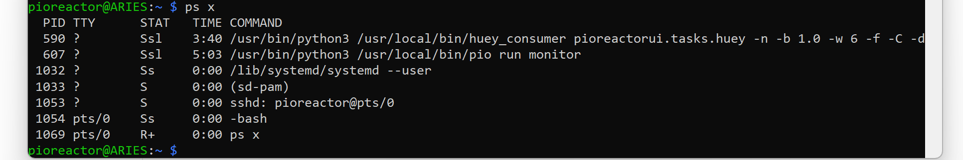

Sorry about the troubles! Are you able to SSH into that worker in that “lost” state? If so, do the logs in pio logs say anything interesting? Furthermore, if able to SSH in, can you run ps x - do you see your jobs there? Ex:
I am indeed able to ssh into when it is “lost”, what i think happens is that something goes wrong which forces the pioreactor to disconnect and then all the automations that were running now just sit in the “lost” state.

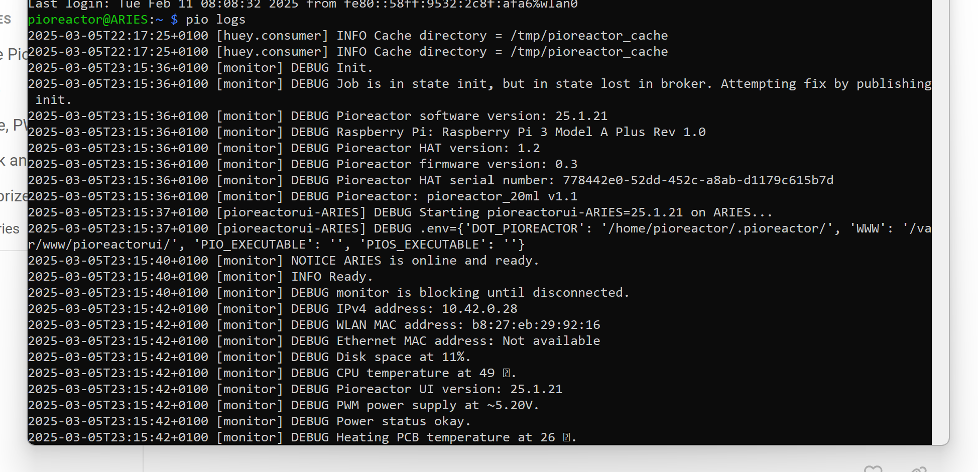

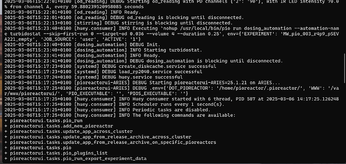

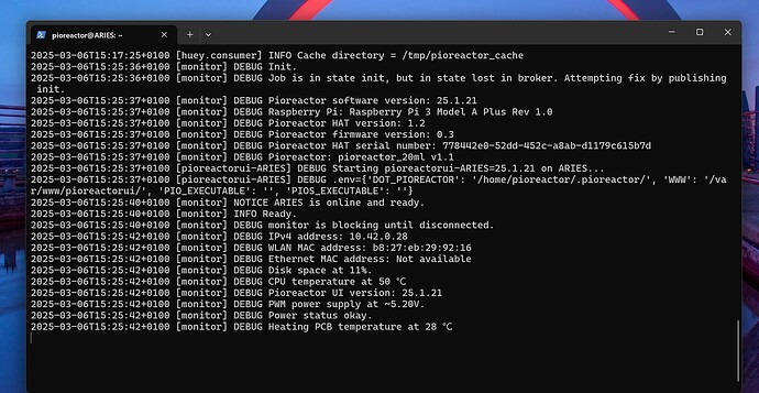

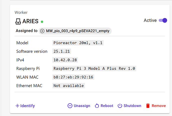

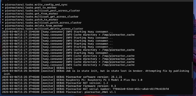

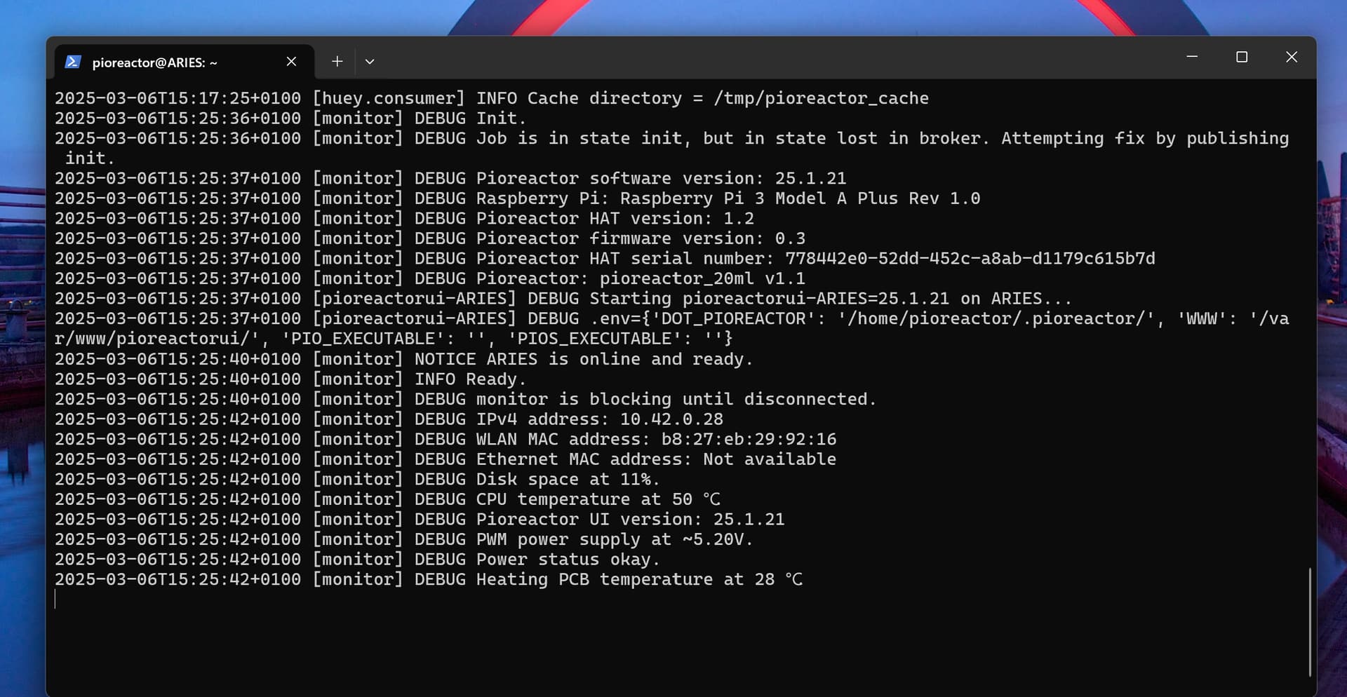

Below are some pictures of the things you asked for:

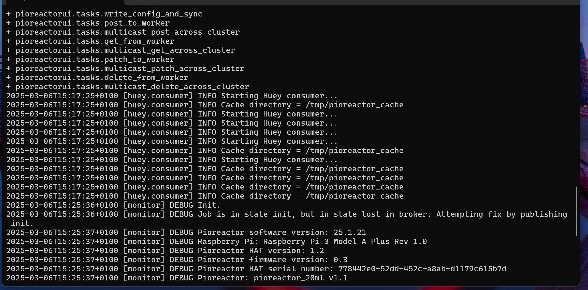

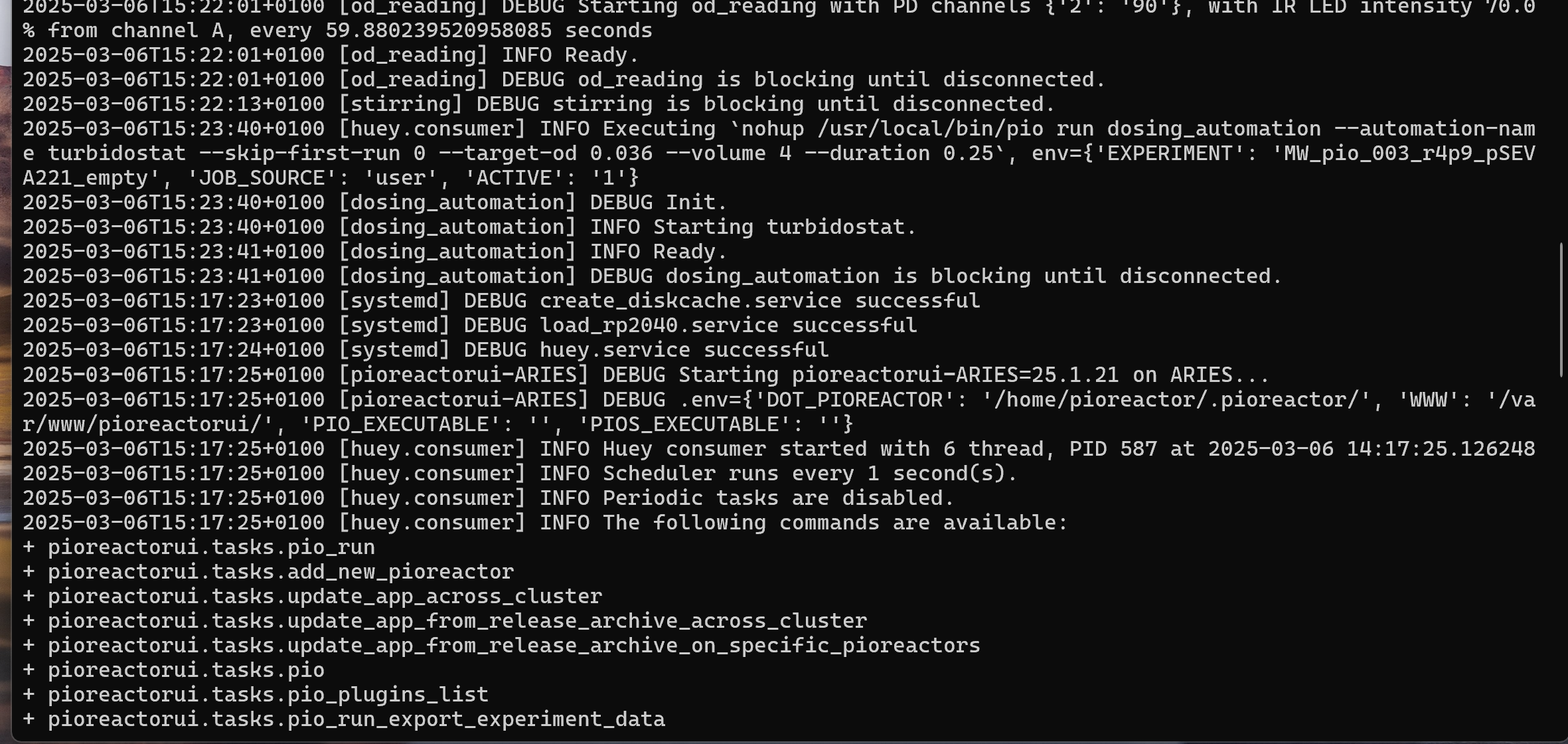

And here are some logs that i got just right now when it crashed again 5 minutes ago:
Yea, I think this is partially fixed in the latest 25.3.5 release (yesterday). What might be happening is your Pioreactor is browning-out (losing power for a moment), and not cleaning up jobs correctly.
