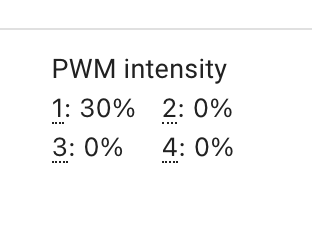

Hmmm, am I interpreting this correctly: when you changed the target RPM from 400 to 200, the actual RPM didn’t change? Only when you went to a much higher value (like 850), did you observe an RPM change?
That could be a software issue, too. In this “problematic regime”, do you see the PWM intensity % change at all when you change target RPM on the Pioreactor card in the UI?
Screenshot 2024-12-30 at 2.18.54 PM
