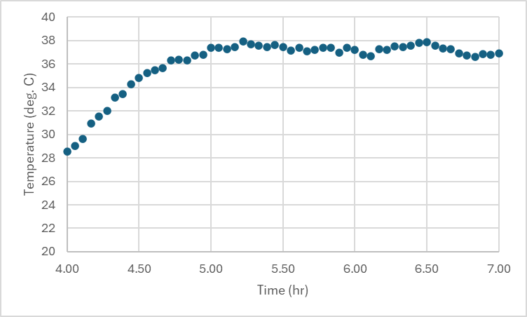

I did play around with the PID parameters, and it certainly helped move the heating output to 100% more quickly, but the issue was more about the total time between a temperature perturbation and the return of the temperature to the target (within a tolerance). I think the most standard term is settling time. This delay is a function of both the aggressiveness of the temperature control loop and the physical properties of the system, like the power the heater can dump into the vial at 100% output and the size of the perturbation.

For instance, here, it takes almost an hour to move from ~28C to the target of 37C. Perhaps I messed up the installation of the heater or perhaps this is somewhat expected performance.

Hi again @KarstenSkogs,
From what I can see, you’ve delved much deeper than I have. Although I do not have a clear answer to your question, I can give my response to some of the questions you asked.
In our side, we heat generally from ~24C to 30C which takes ~0.5 hours. Hence, I do not think you messed up with the heater installation.
I understand your struggle better now. What some of us are doing is to control the temperature of the environment by placing the pioreactors into the incubator. If this option is possible, it can help to reduce your settling time.
