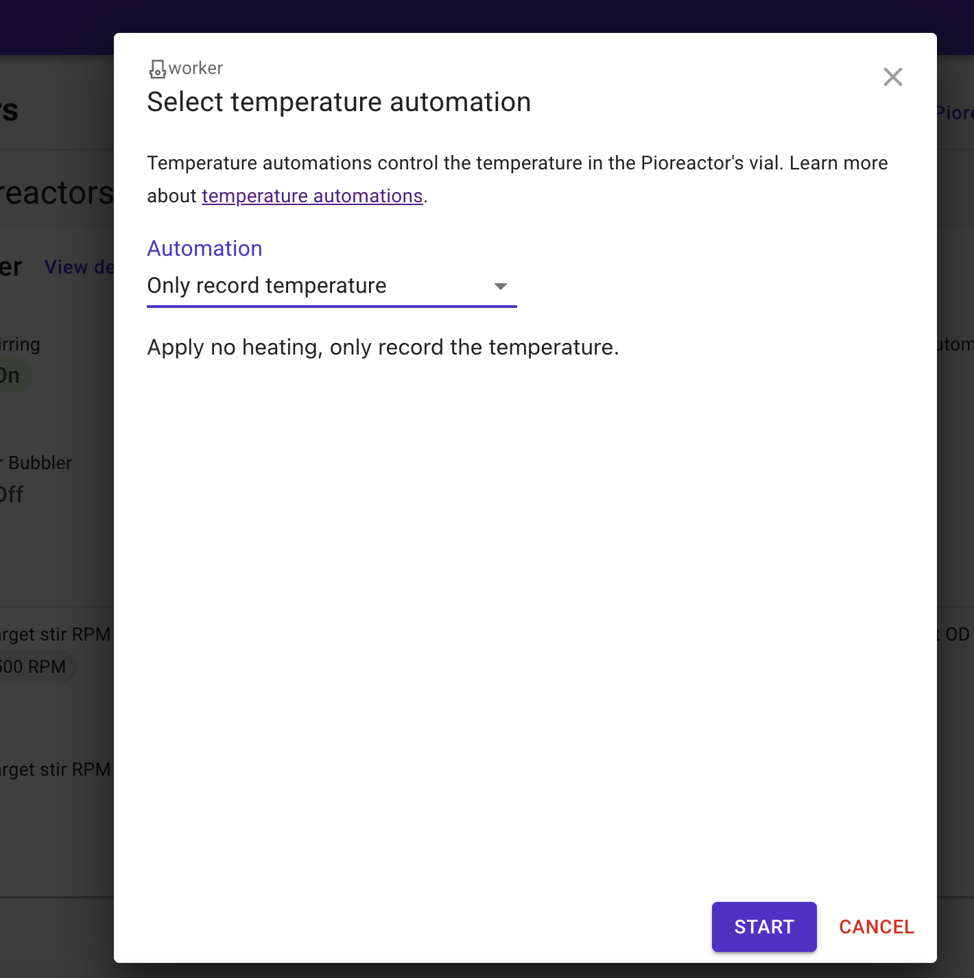

Is there a way for me use the IR sensor without the heater? Or is that the only way to calibrate it? I have my pioreactor in an incubator at 37C, but the temperature of the vessel can still change due to other elements. I tried the code below, but I’m having difficulty calibrating it. I’m not sure if I’m taking the simplest approach here.
