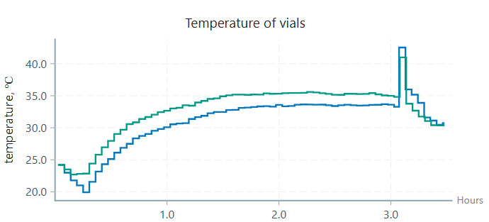

Stopping and starting temperature automation causes short-time heating of the PCB and causes spike in the temperature readings. The picture below shows the spike caused right after stopping the thermostat automation in two pioreactors.
software version: 25.5.1
cluster setup: leader only with workers
pioreactor model: Pioreactor 20 ml, v1.1
Has anyone experienced any issue in this regard in a similar setup?
