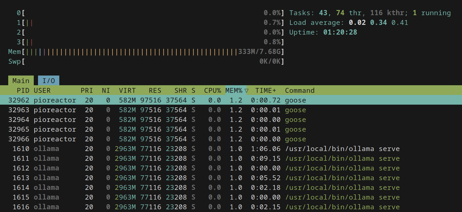

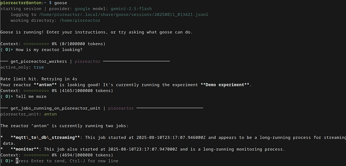

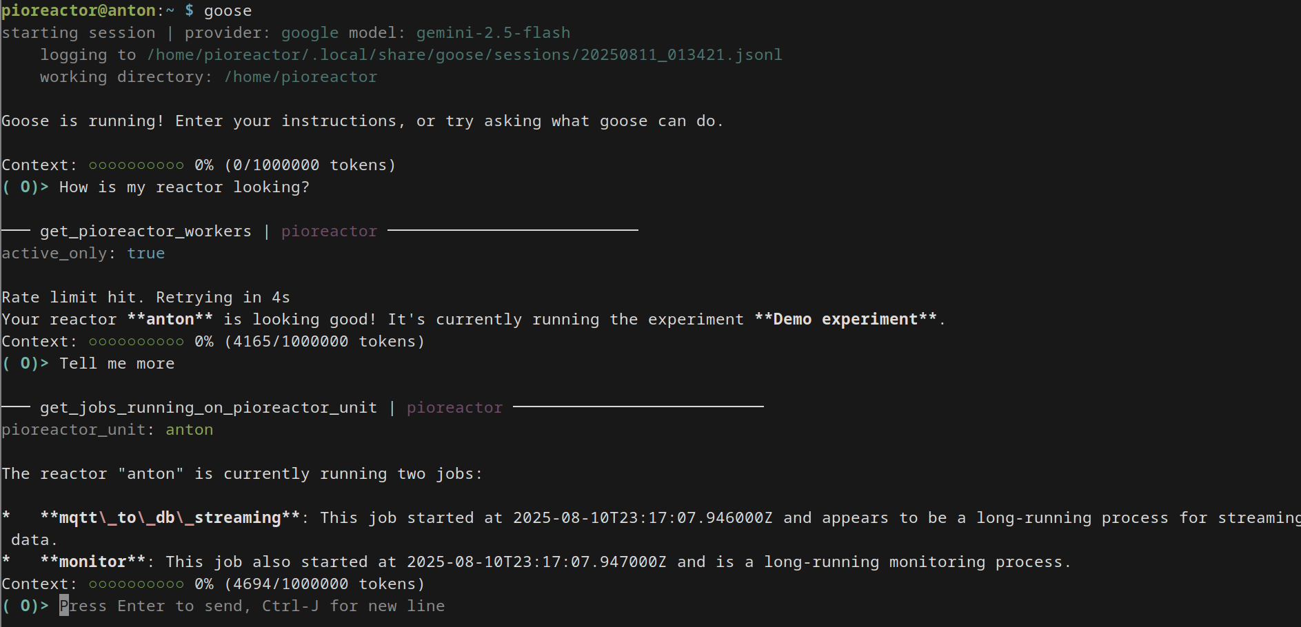

Nice! Obviously lots to test but working for me :slight_smile: Installed goose CLI as well. Running on an 8gb 4b. Only hiccup was that there’s no keyring to store API keys so you have to give them as environment variables to goose. It’s a silent failure though so took a bit to figure out
