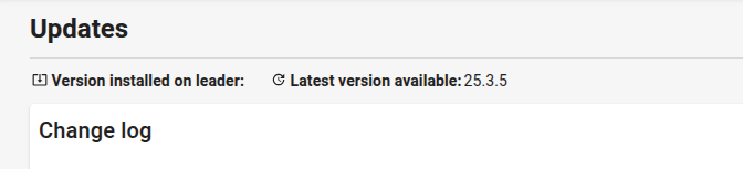

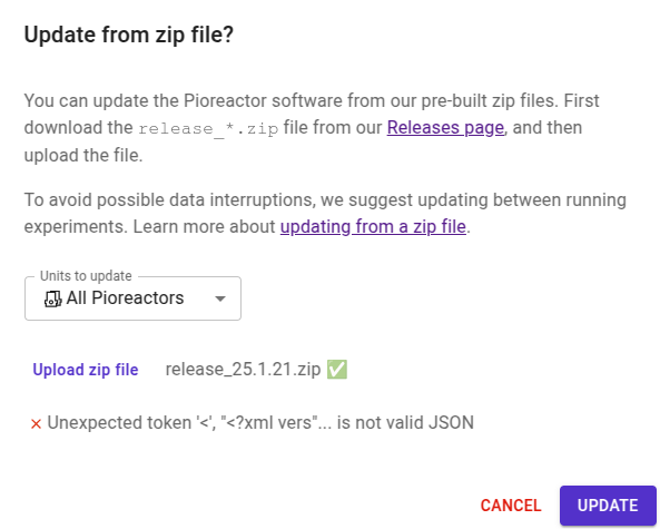

I didn’t read the docs properly and tried to leapfrog too many versions when installing from .zip. I received some errors when trying to install and now the version installed on leader is missing and if I try to install anything from a .zip file I receive an error that I presume is related to this

I don’t really want to reflash the whole OS. Can I just git pull the repo somewhere and reboot? I also made some changes to the pioreactorui folder in /var/www so I guess it could be related to that?
