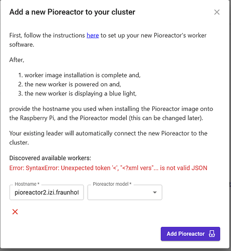

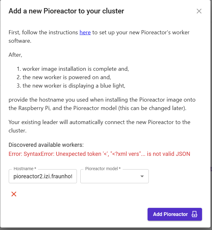

Hey, i just updated to this release but i can’t use the UI or add workers / leaders:
any ideas?
thanks!
Looks like the backend server isn’t working. Can you SSH into your leader and run
pio logs -f
and see if any errors come up? It could just be a config issue.
If that doesn’t show any errors, try:
sudo systemctl restart lighttpd.service && sudo systemctl status lighttpd.service &&
reload the UI, and see if errors appear there.

hey thanks!
this comes up:
pioreactor@pioreactor2:~ $ pio logs -f
2025-09-25T10:33:03+0200 [systemd] DEBUG huey.service successful
2025-09-25T10:33:06+0200 [systemd] DEBUG huey.service successful
here i get nothing:
pioreactor@pioreactor2:~ $ sudo systemctl restart lighttpd.service && sudo systemctl status lighttpd.service &&
so no reaction at all, no errors, nothing happens. same on the workers.

shoot, those && are not what I meant. Try:
while your on the leader, try both:
curl localhost/api/experiments/latest
and
curl localhost/unit_api/jobs/running
Do either success / fail?
